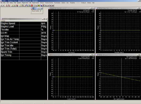

Well I'll throw my 2 cents in here as well. From my perspective we can be assured that there are multiple maps in the ecu. It is a proven fact with many other car manufactures already (notably Subaru) and can be logged by a dedicated and vigilant individual if they feel the need to prove or disprove a point.
So....having said that I think it would be good to discuss "Why" the factory ecu would use multiple maps and "How and when" it uses multiple maps.
Why-Emissions, Fuel Economy, Performance, and Reliability concerns are what Nissan must factor into their product. These responsobilities fall mainly on the ecu as the mechanical portions of the motor and drive line are taken to their most developed iterations (based on budgets as always). The factory must meet emissions over the expected life of the vehicle. Everyone wants to save a few bucks so fuel economy is important, but also Nissan has to appease government regulators and have their entire fleet meet stringent MPG standards, as a whole and individually. Everyone bought a Z/G because it’s a cool car and it’s quick. Performance is a major concern of every owner on this board and we all like "Big Bang for the Buck Factor". Reliability tuning in a NA vehicle is much less stringent then a Turbo car, but remember this as it plays into the discussion a little later.
When and How- does the ECU decide to "advance the map" or use different timing and fuel strategies. Well, just as any EFI race vehicle will tweak their setting after a few runs at the track the factory also realizes that a different set of variables will allow or require a different set of "tweaks" to ensure consistent performance and response from the motor.
The ECU takes a set of signals and based on predetermined logic adds "X" amount of fuel and "Y" amount of timing advance. Electromotive illiterates this using the following equation:
'Pulse Width After All Enrichments =
{(MAP Voltage÷5)×UAP×(VE Absolute% ÷100)× TPS% × CLT% × MAT% × EGO% ×SE%} + POT + BTO'
Some of the terms above are specific to Electromotive, but generally this is the logic used by all ECUs to determine fueling requirements. Ignition trims tend not to be as extensive as fuel trims, but if ignition trim control is present they tend to use the same determining factors as the fuel trims (i.e.-coolant temp, iat, idle offsets, knock, and others). I've attached a screen shot of the AEM EMS software to display graphically the trims (I hope it’s large enough).
So this leads us back to the original "How and Why". Based on the information the ECU is receiving from its sensors it will "decide" on certain timing and fuel adjustments.
Whether the following examples are correct or not they are just meant to give a visual idea of "How" the ECU "thinks"
Example 1: Cold day (Inlet Air Temp(IAT) is low, Mass Air Flow (MAF) is High), motor is able to ingest a larger volume of air and fuel per revolution because the air is denser. ECU adds a predetermined amount of fuel. Now depending on the engines overall design and efficiency the timing may be a lower number in some areas because a denser Air/Fuel mixture tends to have a faster flame front speed.
Example 2:Warm day (IAT is high, MAF is low), less fuel, higher timing number.
Example 3:Cool day High Octane Fuel (IAT is MED, MAF is MED, Knock is LOW) Med fuel, Higher Timing because low count of knock to obtain better performance (This is where the ECU would decide to "Advance the MAP").
Again it comes back to striking a balance of Emissions, Fuel Economy, Performance, and Reliability (warranty or longevity issues) for the manufacturer. So again this is the "Why". A balance of all of the above issues in an extremely complex and expensive machine that has had thousand or millions of hours of engineering time poured into it that is heavily regulated by the government and must drive in a suitable manner for a very very wide range of drivers and in an even wider range of conditions.
So maybe the question should be “How the hell do they do that will only 3 maps?!” Its almost mind boggling to believe that we have such an astounding vehicle with a limited amount of management options.
The multiple map or highly modifiable timing map is an even larger issue with cars that are turbocharged from the factory. The Subaru WRX and Mistubishi EvoVIII are perfect examples. These vehicles are very well supported by the aftermarket and have a host of plug and play piggy backs, fuel computers, and stand alones. It is literally IMPOSSIBLE to tune these vehicles with a piggy back after a certain point due to their conservative ECU fuel and timing strategies. The amount of effort and frustration that is involved with tuning these cars using a factory ECU is unbelievable. Most piggy back owners will relieve themselves of the piggy back after just a few attempts. This is mostly due to timing control, not fuel issues. TurboXS, Vishnu, Unichip, Greddy, Apexi, and a slew of others produce piggy back computers for these vehicles. There is no way to “Outsmart” or “Out tune” the factory ecu after a certain point. Resolution of fuel becomes too distorted. Timing is pulled by the factory ECU at the slightest hiccup. Air Temps and octane reek havoc on the tuners nicely designed maps. It is well known that Subaru ECU’s have such a dynamic amount of timing trim that most owners opt for a standalone or just don’t modify the vehicle past a certain level.
All this was meant to help the understanding of why a reflash should be thought of as a “safeguard” and a “first line of defense”. Sure the Unichip controls some of the major inputs the ECU uses to determine timing, namely Crank, Cam, and MAF signals. But there is always the “What if?”. Until someone is able to take the factory coding, disassemble it and make an equation similar to the one from Electromotive above then there is no possible way of safe “X” piggy back is “100%” safe.
I can say that I know for myself that we do have control of the factory timing maps and fuel maps and that we know where the three maps are located in the thousands of lines of hex code. We know what hex values equate to what number of degrees of timing. This allows us to create a safe level of timing for any FI vehicle. This new base timing can then be tuned and trimmed through the use of a piggy back without concern of phantom timing numbers as described by MIAplaya. Essentially the question is, “Why risk a $X,XXX or $XX,XXX motor because we assume we have factored in all the possible options.” Its kina like Microsoft saying Windows will never crash again.
PS-I hope I haven’t come off as a peter 

so in the situation of timing advance...can it just advanc e the timing a few degrees (increments of 4 i would assume)...or does it switch to a different map...
the reason i ask, i am assuming that even though I had my ecu reflashed to copy the standard map into the advanced map location to prevent any undesireable timing advance that the ecu can still advance timing a bit if a higher octane fuel is used and less noise is picked up by the knock sensor..
what is the case????
ALTERED ATMOSPHERE: thanks again for your excellent customer service!!!
Yes it can and does....this can be seen by running 100 octane fuel on several dyno passes for a reflashed car. Chris Danzio from www.danzioperformnace.com did this on a Turbonetics car he ran the car on the dyno with 91 till empty then filled with 100 octane. After about 4-5 passes the hp started to climb and he picked up near 10 RWHP as a result of the ECU advancing the timing. And yes he datalogged the timing.
Do you know how many degrees? I would assume one....maybe two but it would be good to have hard numbers. We have not done this testing ourselves.
good to know this has been tested, please keep us informed with how many degrees it typically (or has been show to) advance with higher octane fuel...
this would help explain why by my running higher octane it goes a bit leaner...it's running a more advanced timing map with the same fuel values
(I'm assuming that this friend of yours had the reflash for timing that copied the middle map to the advanced map location and the timing could STILL advance just a bit with higher octane fuel---correct????)
