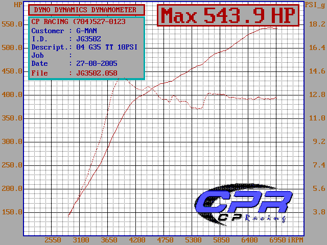

Originally Posted by Sharif@Forged
I am sure G_Man will be posting his dyno charts soon, but we got 543whp out of his car, with only 12psi of booost pressure on pump gas.
Yes I was waiting for them to be emailed to me.
This dyno is with no exhaust just test pipes. I am getting a custom 3" done this week. The boost spikes to 14psi and then tapers down to about 12.5psi. I was told this is because the boost controller is trying to hold the boost at which is was set.

gman: graph looks great... thats the same power i was making with a standalone(100% engine control) at 12.5psi thru that 2.25" borla. you must be running those 550s near the max!! I notice your graph looks very smooth... I wonder if the E-Manage Ultimate doesnt create that same chopiness that was in everyones graphs with the blue E-Manage at those HP levels.
keep an eye out for issues with localized coolant temps... watch your coolant overflow and see if you can do 4-5 repeated runs thru 4-6 gear and see if it overflows out of the bottle. those are the conditions in which I was able to get the heat to really come on strong and cause localized boiling. i would be curious if running with open test pipes is enough heat evacuation to prevent this.
