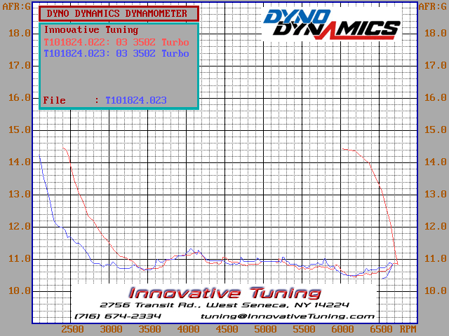

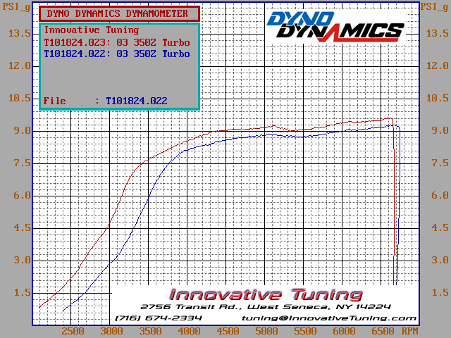

Put on the Borla TD exhaust and dyno'ed my Z. I gained only 7 WHP from the exhaust, but the I gaine like 2 psi from last time I dyno'ed. A/F stay pretty much the same.

Here you go!
Attached Thumbnails T-netics dyno with Borla TD-ptruong9.gif   T-netics dyno with Borla TD-ptruongbst.gif   T-netics dyno with Borla TD-ptruonghptq.gif

Wow, gained +1.5 psi of boost and ~60 whp at 3500rpm...awesome!

I think the exhaust flow is why my car is pushing almost 11 PSI of boost despite the 9 PSI spring.
