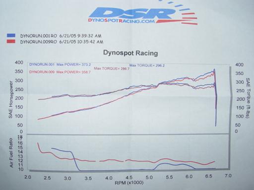

Old Oct 3, 2005 | 08:06 PM
G352NV's Avatar
G352NV
Posts: 2,141
From: Sac
Yeah the odd part is, thats my old system! Heres my tune with the stock Vortech pulley.

Old Oct 3, 2005 | 08:36 PM
acg's Avatar
acg
Posts: 599
From: N.Cal
That looks kinda wierd, even I got 376 with the stock pulley.
