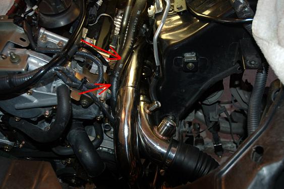

Motor is back in and Im getting everything back togeather. On the RHS dicharge tube its hitting the AC line. The one with the large part near the compressor. What did you guys do here?

I don't have my car right now to double check, but it seems you have routed that line incorretly. I don't remember having any lines running up in that area. I think it would be ran below and on the outer side of the intercooler piping.

Well thats not a pic of my install its anothers on this site. Mine was under that pipe but fit worse so I started looking on the net and found that pic.

This is all it says in the instructions
Compressor Discharge Duct – LHS – DIAGRAM – FMI/01
Bend the air conditioning hose from the compressor vertically towards the engine, so that the rubber hose has 3/8” clearance from the air conditioning compressor pulley.

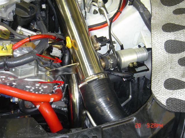

**** heres another one. See how its butting up with those ac line. Looks like its the same on every pic I find but it just doesnt seem right.
