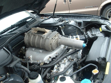

Hopefully come May or June next year a lot of your questions will be answered. Because I'm in the process of laying the groundwork of slapping a B&M forced induction Unit on my FX. Bought new 14 years ago. Lots of engineering to do over the winter! (Having a machine shop helps!)
