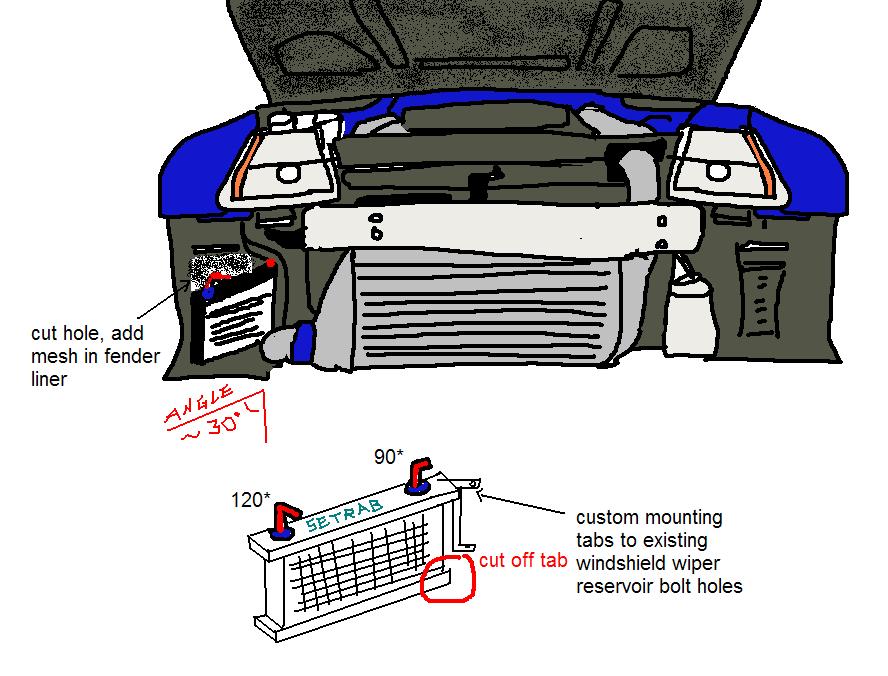

Update..
well. the oil cooler will be the least of my worries after the cracked manifold but if you were still curious about what fittings i went with..
EARL's swivel pipe fittings.
used a 90* and 120* degree bend -10 fittings for the top of the oil cooler, need to find a thermastatic sandwich adapter and use either a 3/8 or 1/2 inch NPT threaded adapter with 90 degree bends, using EARLs superlite nylon holes (six feet worth) to route to the sandwich adapter..
re-routing the oil temp sensor probably to the block so the temps i am reading are MAX oil temps and not after the oil cooler..
i did a quick drawing since i didnt have my camera with me.
gotta love MS paint
Old Nov 2, 2005 | 02:23 PM
  #58
theking's Avatar
theking
Posts: 919
From: Fort Hood, TX
That is exactly where I relocated my power steering cooler and oil cooler. I have a G35 and the Greddy front bumper so it gets direct air. If you roadrace your FI VQ then an oil cooler is a must. I wonder how many people are mistaking boiling their powersteering fluid with it rapidly recirculating through the system and bubbling(not boiling but circulating)?
