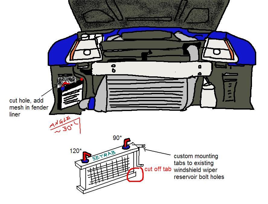

Some part numbers for y'all...
If you're going with a Thermostatic sandwich adapter that has NPT fittings,
then the Holley/Earl's part #s are
90 degree bends for a hose Size 10 are:
3/8" NPT : 829011ERL
1/2" NPT: 829010ERL
If you're using a Thermastatic Sandwich adapter that has AN fitting sizes
then the 90 degree -10AN part number is: 849010ERL
for the Setrab Oil cooler that i'm using which is a -10AN, the swivel hose end part numbers for
90Degree: 809110ERL
120Degree: 812010ERL
see draw2
Edit: Ordered teh Mocal, 20mm filter thread size, 180*F Thermastatic Sandwich adapter... Part Number SP1FT ~$80.00. It has 1/2" NPT fittings... it's pretty compact. at 1.26" thick.. yay...
Attached Thumbnails Oh F#$%. 265*F Oil temp when HPDE...-oilcoolermount2.jpg

Originally Posted by 350zDCalb
ummm, anyone? (bump me question)
well these are the exact part numbers for MY setup...
1. Setrab Oil Cooler, 25 row, 13.0"x7.5"x2.0", -10 AN fitting,
Setrab part number #50-625-7612.
2. Mocal 180*F Thermastic Sandwich adapter, 20mm filter (Nissan) with 1/2" NPT fittings.
Mocal Part number# SP1FT.
3. 90 degree bends for a hose Size 10. These are for the Mocal Sandwich adapter.
1/2" NPT: 829010ERL.. you need two of these.
4. -10AN, the swivel hose end that attach to the Setrab cooler are:
-10AN, 90Degree: 809110ERL
-10AN, 120Degree: 812010ERL
5. 6feet of the EARLS prolite nylon hose size 10, i dont have the part number for that...
here are the picts of the EARL's fittings.

Originally Posted by Chebosto
...i did a quick drawing since i didnt have my camera with me.
gotta love MS paint
Yet another Cheston's DRAW.
lol...
