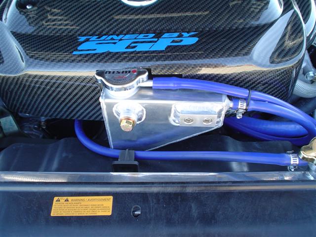

Default Air Separation/ Breather Tank
I am running an air separation tank, so the thermostat could definitely be the issue. I ma currently running the Nismo thermostat. Does the heater blow cold air if the thermostat is toast? Here is a pic of the breather tank.
SGP installed this, and it worked well until the other day. Apparently either air is trapped or the thermostat is bad.

Do you know where all the lines are running? Did they weld up the radiator?

One line runs in from the radiator (the top of the radiator for purging) and the other runs to the ground to allow air and/or coolant to exit. They did not weld the radiator, just replaced the cap with a cap with no spring that will not blow.
