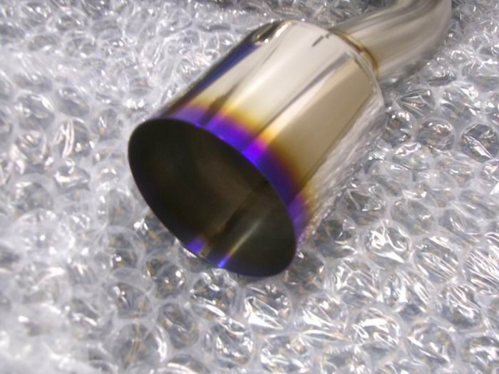

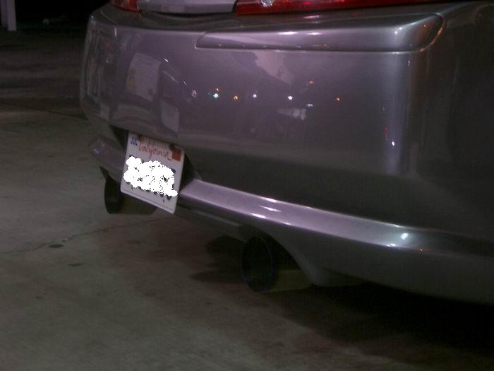

Actually, I'm not sure about the TN flash blowing everything away that Techno did. The fuel maps will change and the rev limiter will go back to 6600 (99% sure, will verify). I won't mind if they leave the top speed governor off. Hehe. Not sure about the throttle positioning at WOT. I'll ask Mia about it tomorrow.
Amuse:
http://media.putfile.com/Amuse-WOT-at-the-track
Attached Thumbnails Will stock Turbonetics blowup?-g35_amuse_right_rear.jpg   Will stock Turbonetics blowup?-amuse_tip.jpg   Will stock Turbonetics blowup?-amuse_canisters_three_quarter.jpg
