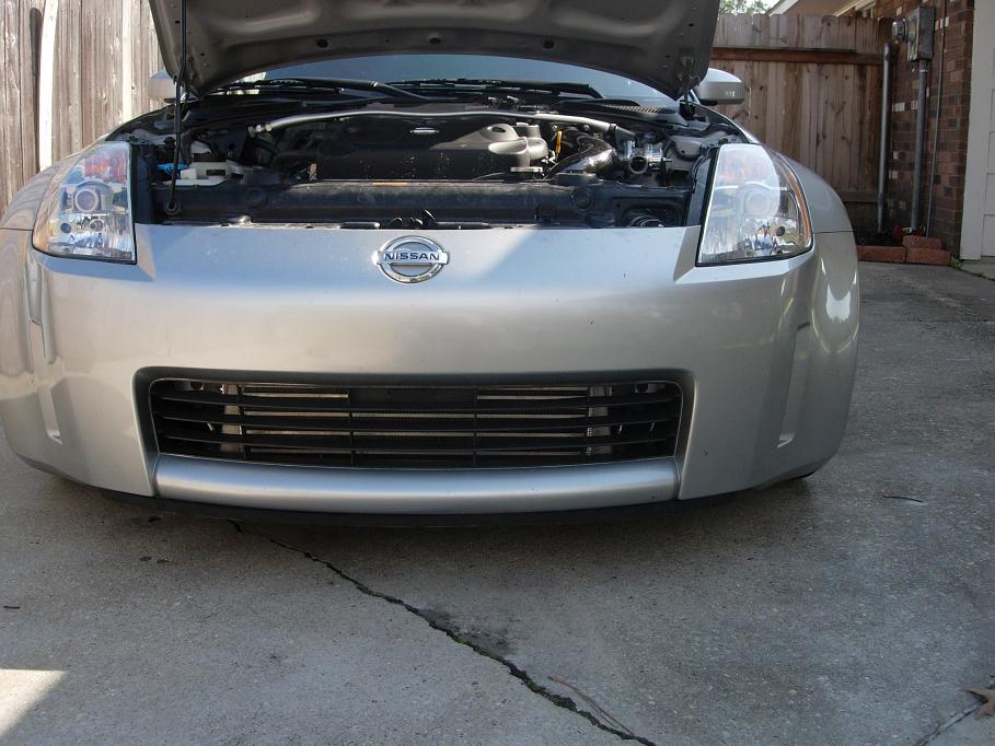

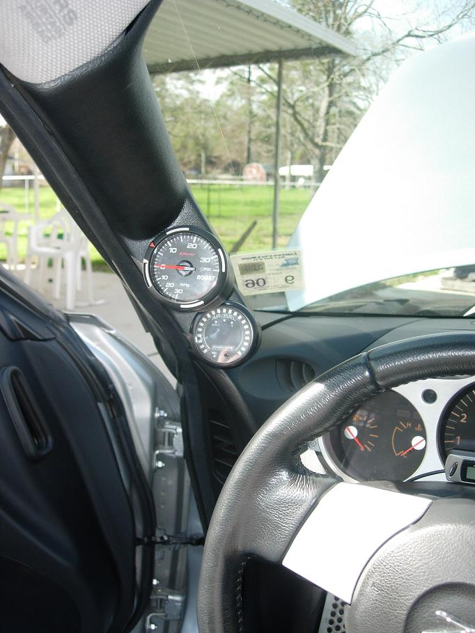

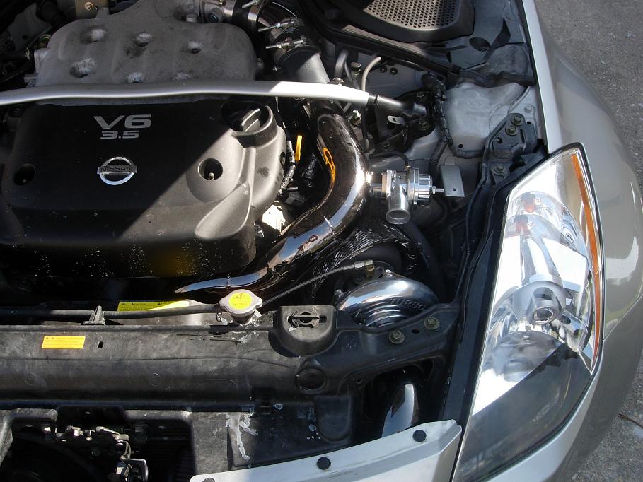

Just got in from the shop with the TN kit installed. First impression is the car is a lot different. Idles diff, vibrates diff, sounds diff, and most of all makes a lot more power. This was the shops first 350z install, but they have done a lot of other cars. They did a really good job (so far anyway), and i dyno it tommorow at 10am. My car w/ a pop charger made 233.8 whp, and im hoping for 350 with the kit. The car is bone stock except the kit. Just thought i would share. Here are a few pics of the kit in the car (looks like every other 1k TN kits in ) . BOV is probably the coolest sounding thing i have ever heard.
Few questions. When i come off the throttle, the wideband sometimes goes into the high 20's and even even just says 02 at times (only coming off throttle) Is that normal? So far under full boost it looks like 10.8 and staedy boost reading of 8 lb's. Big ups to Alberto and MIA for holding my hand!

Thing of beatuty... When you come off throttle you are going WAY rich when the BOV vents...probably just ECU over compensating timing to get you stoich again. As long as at idle you are at 14.7:1, under boost 11.5:1 or lower and part throttle between 11-13 you should be fine..Congrats!! Anytime you need help just let me know..
At idle i am 14.8 - 15.1 consistantly. On boost it is ROCK solid at 10.8

congrats and welcome to FI, i wish the turbonetics kit was out when i went FI, you'll enjoy the crap out of it, if you ever add a tunable kit you'll get a better tune and way more power,10.8 is pretty rich, 11.8 is a good place to be with a good tune. let us know the numbers when you get dyno'ed.

oh, your gages look sweet, much like mine

That is so awesome man Im very happy for you. Im sure you'll be driving around all night. When you let off the gas-in other words no load your WB will go unreadable lean-dont worry your motor is just an air pump @ that point its not dangerous. Your A/F is nice and safe and your idle A/F is perfect. Very happy for you Im glad you finally got it in. Any Q's feel free to hit me up. BTW your missing the horn on the BOV....

GOOD CATCH ON THE HORN!!! I didn't even notice...heres what it should look like If you don't have the horn are didn't get it in the kit call Reggie at 805-581-6710 and he can overnight one to you...
