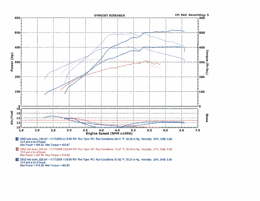

3 pulls are off, low and high boost.
Attachment 95819
This is the greddy TT kit with a built motor?
Can you provide specs?
CR?
Cams?
boost?
EMS?

what is the off, low and high boost? how many PSI?

Built greddy TT
EManage blue
HKS EVC EZ
Stock intake and exhaust
off- 5.6 low 8 high 15

Hard to read the graph, but what is your A/F between 3500 - 6500 on your best pull?
Built greddy TT
EManage blue
HKS EVC EZ
Get an exhaust on that setup and let the car breath. you have an upgraded fuel system on it?

AAM return fuel system
yes, still have emanage blue. Waiting for AEM EMS.
