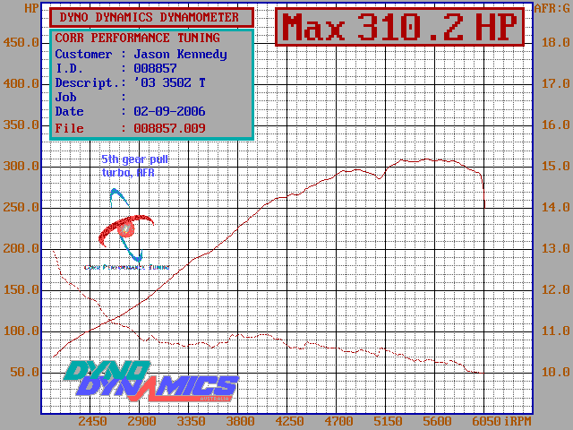

Just dyno'd the new TN kit
Old Feb 8, 2006 | 01:05 PM
Sharif@Forged's Avatar
Sharif@Forged
Forged Performance
iTrader: (92)
Posts: 13,733
From: Marietta, GA
DynoDynamics does not offer SAE correction. They use atmospheric correction, but not official SAE constants.
311whp on an uncorrected DynoDynamics dyno is probably about right. We dyno stock Z's at 195-200whp without correction on the DynoDynamics dyno.
The higher trq number could be a result of the ECU reflash tune...either too much timing retard, or too rich up top...so your power falls off prematurely.

I just got off the phone with a few people, and they really urged me to take it to a local dynojet. I'll get the sheet up when I get it.
That was my mistake then to say SAE corrected without knowing for sure. They did say it with air quotes "SAE correction" when he put the thing on my airfilter. I made an appointment for next Thurs on a Dynojet. The shop is pretty uptight about imports, so lets hope they stick to the scheduled time. Unfortunately here in Louisiana we don't have many dynos.
I do know my butt dyno says it a LOT faster than it was. The car with stock wheels and tires breaks loose in 3rd, which is a pretty big smile factor.

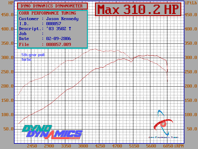

Default re
Dynos
Attached Thumbnails Just dyno'd the new TN kit-350z3.gif   Just dyno'd the new TN kit-350z4.gif

Based on everything listed here you should definitely attempt to get on a Dynojet dyno ASAP to get some other numbers

Originally Posted by jason333
Dynos
Definitely get to a Dynojet...The AFR looks ok as well as the curve but the numbers are just not looking correct.

weird dip at 5k
edit: NM i hadn't looked at them close. It looks like it gets fatter at 5k
Old Feb 8, 2006 | 05:25 PM
MIAPLAYA's Avatar
MIAPLAYA
Posts: 11,373
From: Escondido
weird dip at 5k
Thats pretty common. Thats Turbonetics DUMPING fuel as the MAF runs out of resolution.

I think its a combination of dyno and possibly a leak somewhere. Running that rich is not normal.
