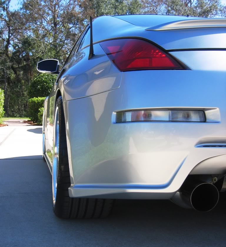

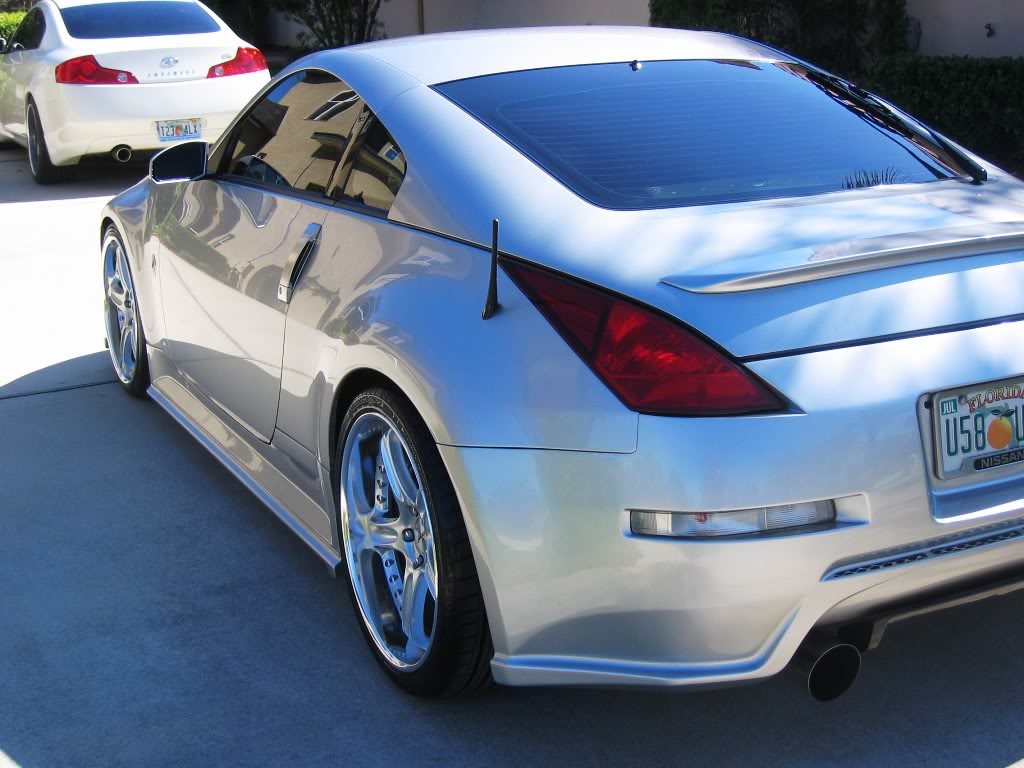

Jet, here you go. I just changed up to a 305/25/20 Continental SportContact 2. The rear wheels are 20 x 10.5 with 26mm offset and fenders are cut. Previous setup was a Michelin Pilot A/S 285/30/20. Traction is definitely better, but not substantial.

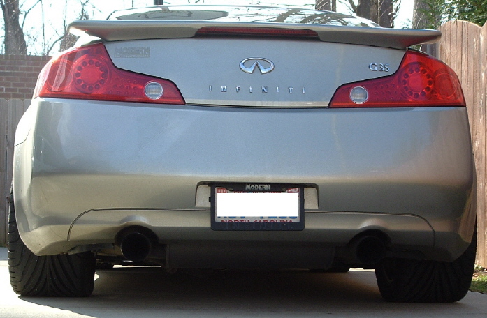

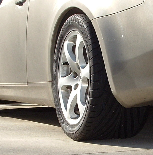

315's on widened stock 8in rim(now 10&3/8in), plus 25mm h&r spacers
ati,7psi,g35coupe,a/t, goodyear gsd3
Attached Thumbnails 305 Rear Tire ???-widerrims-002350z.jpg   305 Rear Tire ???-widerrims-g35.jpg
