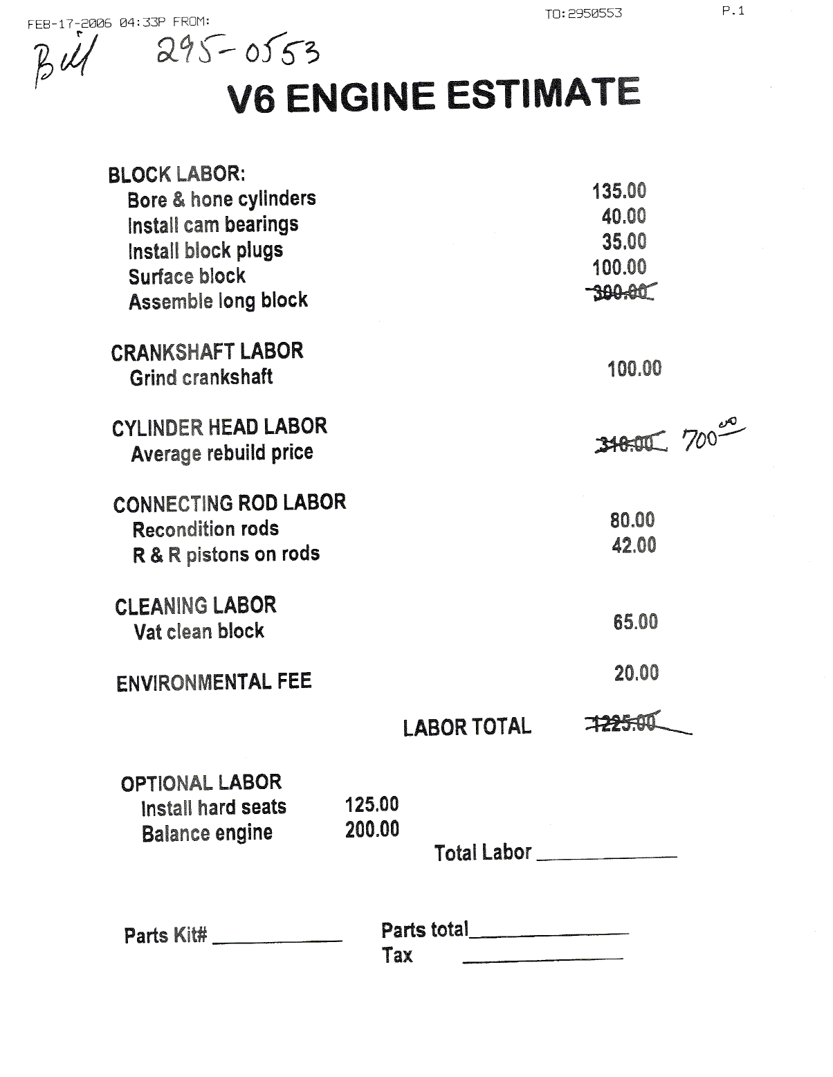

I just got off the phone with one of the machine shops here and he sent me a list of rough costs for each job.
I also asked him about the matching of pistons to each cylinder and he told me that on brand new pistons, it's not necessary. However I have heard from more than one person about having this done. What do you think?
Also what on this list should I have done, and what is missing from the list that I need to have done?

one thing is that there are no cam bearings to install. which that would fall under head work on an overhead cam motor anyways. looks like he gave you a generic quote sheet. i would also have the block checked for flatness before getting it decked. i'm guessing he is figuring decking both the block and heads. best to figure out if it even needs to be surfaced at all, as doing both can effect cam timing and intake alignment if too much taken off. also depends on the type of equipment they are using to resurface with.
also, have the crank checked first for out of round and taper before they attempt a regrind on it. chances are you will still be fine to not have any crank grinding done. not to mention it will make it very challenging to get the correct bearing combination on each saddle.
are you using stock rods or after market ones? the rod conditioning cost has an effect on this. also r&r for press fit pins. most aftermarket rods are designed for floating pins and make it so anyone can install the pistons/ rods with spiral clips.
i trust my machine shop alot. since they also know i know what needs to happen, but don't have the tooling to do myself, they do exctly what i ask for. depending on your current mileage also has an effect on the amount of work that might need to happen. even matching the stock bearings can be a good education in code breaking techniques, it would be harder to figure it out with a ground crank. it sounds as though these guys have never worked on a vq35 before by the qoute. not to say they are not good at what they do, but they just havn't done this style motor before. a bore and hone is simple for most machine shops to do. the good ones (especially for forged pistons) will bore each cylinder then mic each piston and hone to the lower end of the clearance spec to reduce piston noise at cold start up. on a side note, the better quality piston and rod combo you get, will result in better initial balancing and a greater chance the cylinders can all be honed to the same spec too.

Based on what this guy told you "No need to match the pistons to the cylinders" would make me advise you to find another machine shop.
Each cylinder is going to be a slightly different diameter, and each piston is going to vary ever so slightly as well. In order to achieve the proper piston to wall clearance, each piston must be matched to each cylinder. Depending on the pistons, the piston to wall clearance will range between .003 and .005 inch. Take a look at your piston job card or spec sheet for the correct spec.
Also make sure your machine shop uses a trq plate. Since most shops dont have them, we have one for rental if you need it. Shoot me a PM.
