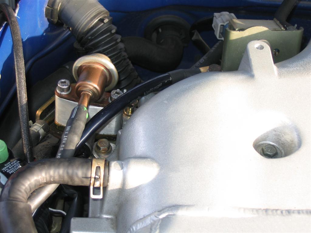

Sorry I cant help you with t-fitting questions but look in the N20 section I know many of those guys use t-fittings. Why dont you just buy a $50 SPT fuel tap, you can use it for a guage, and takes 2 minutes. Pics below with a Defi FP sender tapped in...

+1 This is what I did but I used the AAM fuel pressure block adaptor.
