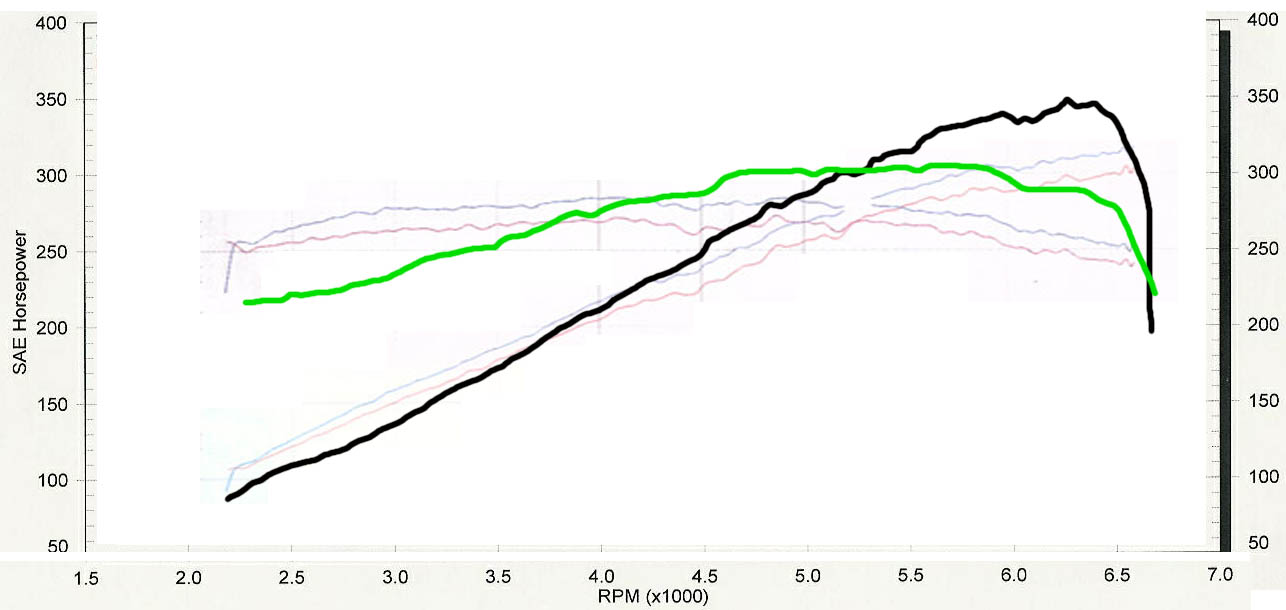

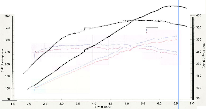

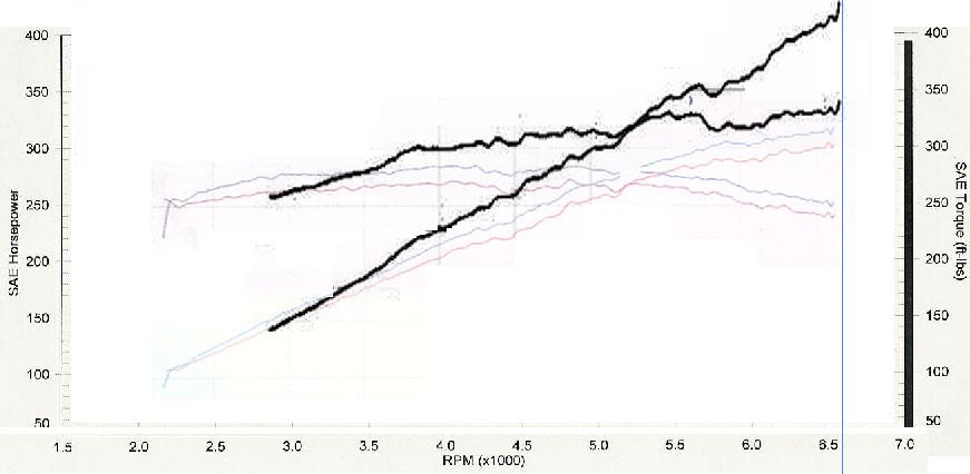

I did an area under the curve % of a 323whp stillen stage 3 vs a 350whp, 400whp, and 450whp vortech
I reached my % by filling in the area under the hp and tq curves seperately with black, then the empty space with white. I ran that block of data thru an average function to give me a grayscale % number of how much black (or area) is in that sampled area
I'll attach the dyno charts I used - there is some slight error just from these being different cars on different dynos at different locations, temps, humidity, elevation etc, but ballpark-wise should be reasonably accurate.
The first picture just shows what I mean with the area filled in for stillen hp, tq, then 350whp vortech hp, tq, 400whp vortech hp, tq, 450whp vortech hp, tq
2nd picture is 323whp stillen stage 3 vs 400whp vortech
3rd picture is 323whp stillen stage 3 vs 450whp vortech
4th picture is 323whp stillen stage 3 vs 350whp vortech
some of those pictures I traced over and changed the color so you can see it better since most dynos show red and blue lines it starts getting hard to read with multiple dynos
Dynosheets don't ever plot out anything below 2000 rpms, but if it did and that data was factored in, the stillen would fair just ever so slightly better in some of the lower rpm percents

Attached Thumbnails Which SuperCharger?-areas.jpg   Which SuperCharger?-stillen_vs_vortech1.jpg   Which SuperCharger?-stillen_vs_vortech2.jpg   Which SuperCharger?-stillen_vs_vortech3.jpg
