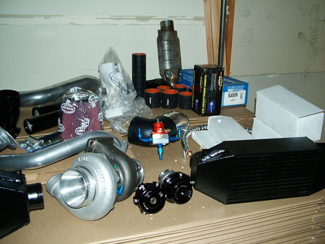

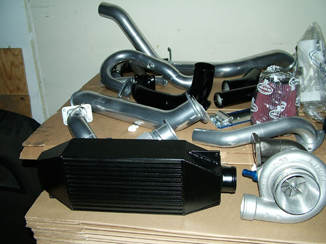

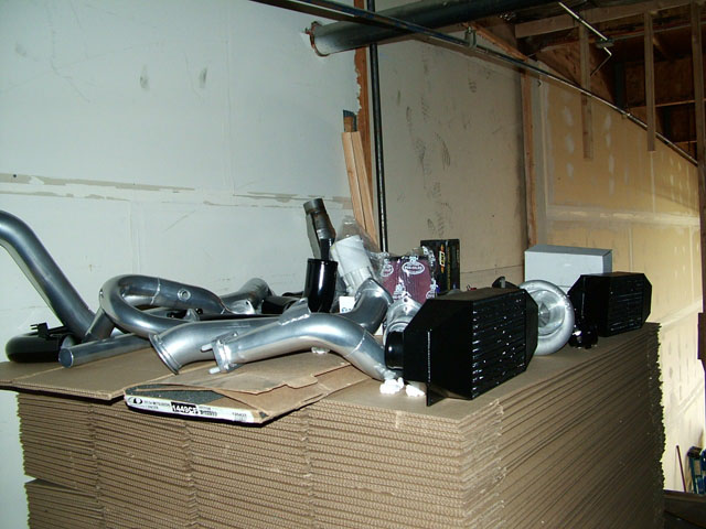

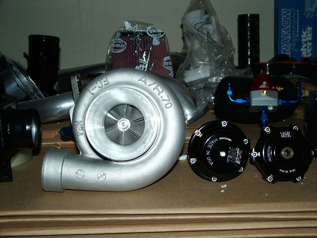

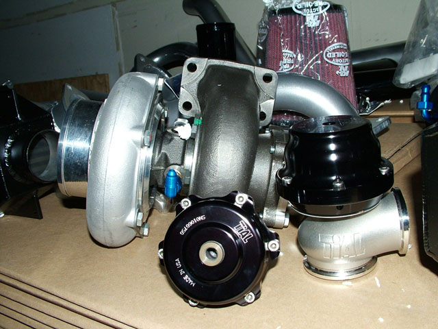

I've finally received my custom Eternal Motorsports ST kit for the G35. The install should be finished by Friday. I plan on going to the Dyno day at Church's this Sat to find out what it can do with the EU and 91oct.
The kit is also on Damen's car who is a member here also. The kit pulled 392hp/415tq on a dynapack using the unichip and 93oct with a stock exhaust and 3in cat with no other engine mods on his car. I should pull the same or a little higher since I have a crank pulley and borla TD since I'm using crappy 91oct for now.
The kit comes with everything you need including 1 step colder spark plugs and JWT oil pan spacer. The kit is only made for the G35 with dual intercoolers. I had the IC piping coated black along with the ICs' for the stealth look even the BOV is black. I will post pics of the install while in progress, but for now here are pics of the kit out of the boxes. Also my car is a 5AT I already have the Stillen VB, but I plan on installing a TC and tranny cooler soon. Tell me what you guys think I know that this kit for a G35 only, but I know most FI G guys hang out here. I know that I do for the most info. Enjoy

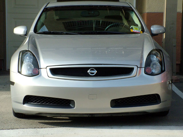

Here is some info on the kit pm me if you have any questions. Here are some pics of my G. I also plan to get a smog check to see if it passes since it has a cat.
Designed for 2003 –Up Infiniti G35 and M35. *Bolts directly on to the stock VQ 3.5 L engine. *No additional modifications.*
*Uses stock manifolds, cutting down on installation time. *Garrett GT35-R dual ball bearing water cooled turbo and includes:
*External TiAl 44mm waste-gate. *3” down pipe that connects to a high flow catalytic converter that mounts to stock muffler.
*Stainless steel heat shield. *440cc fuel injectors. *Fuel pressure regulator and Walbro High Flow Fuel Pump with fuel return.
*Air to air intercooler. *Ceramic Heat Coated Stainless Steel piping (available in polished look, flat black, or red finishes).
*All required hardware and installation manual is included. *Stainless steel braided Teflon water and oil hoses.
*Pre-programmed piggy-back UniChip fuel management that interfaces with stock ECU.
*Performance from stock 3.5 L engine at 8.94psi is 392whp and 415 ft lbs torque.
*Smog compliant in most states with standard boost. Check your local laws prior to purchase.
*Boost Capabilities up to 25 PSI with internal engine modifications.
*Some A/C lines are replaced and or relocated. Everything needed for installation is included in the kit.

That intercooler is awfully small. Do they have an option to fit a larger unit?
Old Mar 27, 2006 | 02:55 PM
MIAPLAYA's Avatar
MIAPLAYA
Posts: 11,373
From: Escondido
Theres two of them I think...but I'd still like to know max power for that core. Thermal efficiency? Pressure drop?
Yes there are 2 of them. Rob how can I find out that info and what is good?
Old Mar 27, 2006 | 06:18 PM
MIAPLAYA's Avatar
MIAPLAYA
Posts: 11,373
From: Escondido
Well what you are looking for is a less then 1 PSI pressure drop and thermal efficiency that will give you intake air temps as close to ambient as possible.
