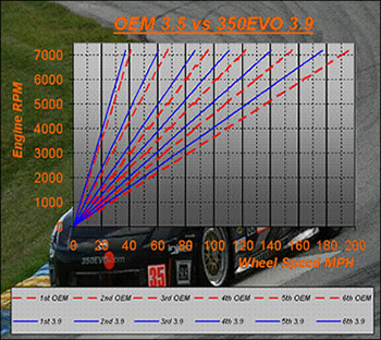

I don't quite get what you are trying to say. He isn't changing the gear ratios inside the tranny. Why would this put him past his peak torque?
Originally Posted by sentry65
I wouldn't do it, when you shift, your rpms are going to be too high and you'll be way past your peak torque and I don't think the increased rpms would offset the huge mountain of peak tq that a turbo will give you at around 4000 rpms.
good point, I suppose I was wrong on that
