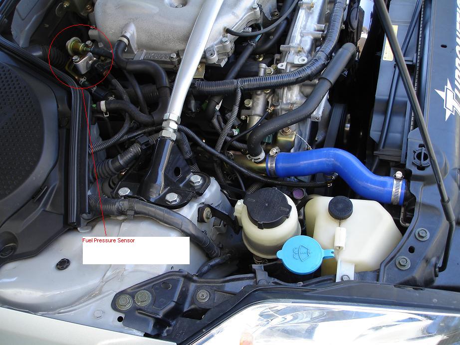

The regulator governs fuel pressure output at the fuel pump assembly output. When you install the Walbro 255 lph pump the output of the pump overwhelms that regualtor and the result is fuel pressure in the 70s or 80s at idle. By opening up the orifice on the regualtor a bit you reduce the fuel pressure output at the pump and therefore downstream. Example, without that done my car read 76 PSI of fuel pressure at the fuel rail feed (condensor). This of course was during kit design. After the fuel pressure reg modification my fuel pressure reads 53 PSI at the same location. I'll attach a pic of where I am reading fuel pressure.
I have the same AAM fuel fitting..I can believe the opening the orifice will reduce the pressure since you experienced it but i'm stumped as to why??..The pump pulls fuel out of the tank and passes it on to the regulator..If the regulator orifice is too small flow is restricted and the pressure drop is high resulting in a low downstream pressure at the fuel fitting. If on the other hand the orifice is too large flow is high and pressure is low at the fuel fitting..But apparently the opposite is happening..Has something to do with a guy named Bernoulli...
