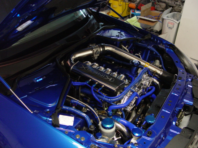

Naw its stock. But a lot has been changed. I just cant find a leak., its almost like a burnt coolant smell.

wow that sure does look purdy!
