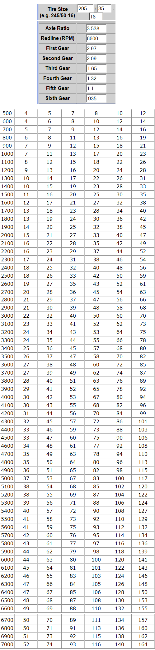

does anyone else think the Z's gearing isn't really ideal for FI levels of power?
1st gear is obnoxiously short - even with the 3.36 final drive.
It seems to me the ideal gearing would be to make
1st gear a lot taller
2nd gear a little taller
3rd gear roughly the same as stock
4th gear slightly shorter
5th gear shorter
6th gear a lot shorter
This would enable the car to hook much easier and even out the time spent in each gear at WOT to be roughly the same where as it is right now the lower gears are really fast and you spend a lot more time in the higher gears.
It seems like obviously the lower gears need to be taller and the higher gears need to be shorter for the best accelleration - this wouldn't be ideal for great gas mileage cruising down the highway though
I've attached a picture of the gear ratios I've plugged in. The gear ratios I've come to while still using the stock 3.538 final drive are:
2.97
2.09
1.65
1.32
1.1
.935
for reference, stock gearing is:
3.794
2.324
1.642
1.271
1.00
.794
you'll notice that as you shift at redline, the starting rpms in the next gear get progressively higher and higher which I think is exactly what you want when you're racing
I know it's possible to change gear ratios in the transmission, but probably isn't going to be cheap. 350EVO said they could do such a job if someone wanted to try it. I'm just thinking this seems like a better choice than something like a boost controller that limits the amount of boost in each successive gear
anyway, guys with turbos have gone to the 3.36 FD and that seems to make 1-3rd gears slightly easier to use, but at the expense of 4-6th being so much taller than before that you're losing a lot of accelleration in the higher gears - seems like a trade off rather than a 100% improvement
you'll notice in F1 racing that they spend roughly 2 seconds in each gear for the most part. Not, 4, 2, 2.5, 4, 6, 14 sec etc
Attached Thumbnails FI transmission gearing-fi_gearing.gif   FI transmission gearing-fi_gearing_graph.gif
