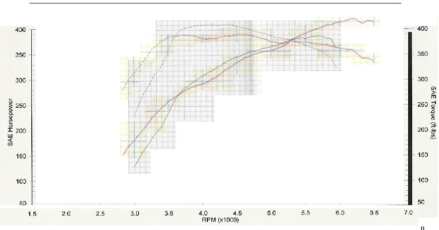

here's a TN ST and a greddy TT. I forgot who's dyno curves they are, but you can't even really compare dyno curves accurately unless they're from the same dyno on the same day
these are not, so take the differences with a grain of salt as more of a general ballpark sorta thing. I don't even think they're quite making the same power level on top of everything

Any annotation as to what color represents what? Even though I have a good idea..

the gray/blue is TN, the red is greddy

Good stuff...

are they the same PSI?

Thats VERY doubtful based on the power production...

who knows, it's impossible to accurately compare dynos. I said it was just a ballpark chart
besides, psi isn't an absolute measurement to compare cars by. You can have 2 cars with 8 psi, but one has cams, plenum. test pipes and dual exhaust and the other is bone stock.
The one that can breath better will have much higher numbers even though the psi is the same. All a boost gauge measures is pressure, not air volume or velocity.
Like dynos, boost is really only relative to that specific car
