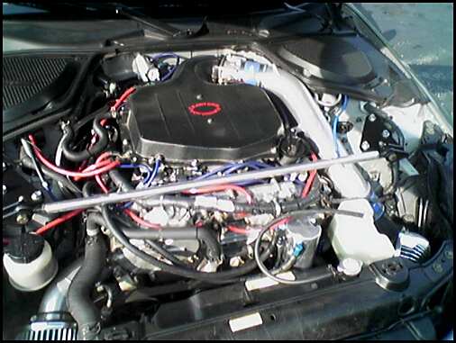

Got my cusco oil catch can in yesterday and I mounted it in the engine bay between the radiator and the engine. I saw many pictures of the lines going to the hose that is at the intake manifold and to the pcv valve on top of the passenger side valve cover, but then I noticed alot of guys with FI have them running the other direction, but I don't know where too. So, where is the best place to run them too or is where I have it fine?

thanks alberto, i read that thread, but must have just been skimming because I completely missed that post (guess i was more searching the pictures, wish I could see all of Todd's in the first post ).
So, how exactly should it be routed then? One hose goes to pipe on the side of the drivers side intake, but where exactly does the other end of the catch can go to?
here are a couple of pics of where it sits now (good 'ol camera phone pics)...
Attached Thumbnails Oil Catch can install question...-catchcan1.jpg   Oil Catch can install question...-catchcan2.jpg

Here is my carbing catch can.

why does every thread about catch can installs end with out a FOR SURE answer on how to install it! You'll see plenty of pictures about the pass side PCV valve, but nothing about the driver side. HELP!!! The about pic tells me NOTHING except where he installed it, not HOW he installed it!!!
The drivers side you can put a filter on and vent it into the atmosphere. Just plug the hole on the intake tube. If you guys actually look at the upper and lower intake manifold, you can see which hose has the most oil vapor. The passenger side goes in the middle of the manifold where there are very tiny holes that vaccum in some oil. The drivers side is the hose that distributes the oil and oil vapor into the upper and lower manifold through the TB inlet.
