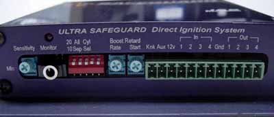

and here is what J&S is saying on the web site i should have:
here is what mine looks like:
http://www.jandssafeguard.com/safeguard.html
as i continue to read, the guy thats working on my car seems to think it may be Interface adapter module... any thoughts? I'm still trying to get a hold of these guys.

update:
John wrote me back saying he is going to upgrade the out-put drivers for $50. Hopefully that is the problem
