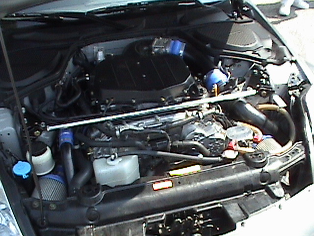

Heres my PE TT kit powder coated in black
lookin clean bro. Ill have to do that someday.
