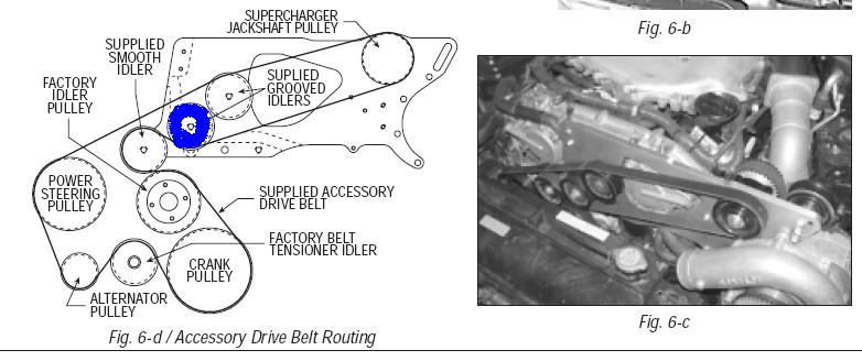

One of the supplied grooved idler pulley from the vortech was bad and it didnt spine (i believe a bad bearing and is being ordered). My question is, will that affect the results? My tunner says it should not change the dyno # at all so I'm quite confuse on how everyone and their mother are able to get 370+ with the smaller pulley????

1 of the pulleys on the vortech wasnt spinning so it was making a loud noise but got quieter as u left it running. He said the bearing was bad and it was making the noise and not making the pulley spine.

The pulley in blue is the one that wasn't spinning freely.

Was the belt touching the pulley? If it was, I am surprised that the belt didn't start to smoke from the heat generated by the friction of the belt running over a pulley that was not turning. The fact that the guy actually ran the motor like that would send me running and screaming in the other direction.

I believe the belt was still touching against the pulley, that is why it was making a lot of noise and eventually it quieted down a little but still noticable. At first I thought my blower went out but he explained it was a bad bearing and it stopped the pulley from spinning. So wouldnt the friction of the pulley cause the belt is slow down a bit? I still dont know what the psi level was at and I'm hoping that is the reason for the low hp/tq.
