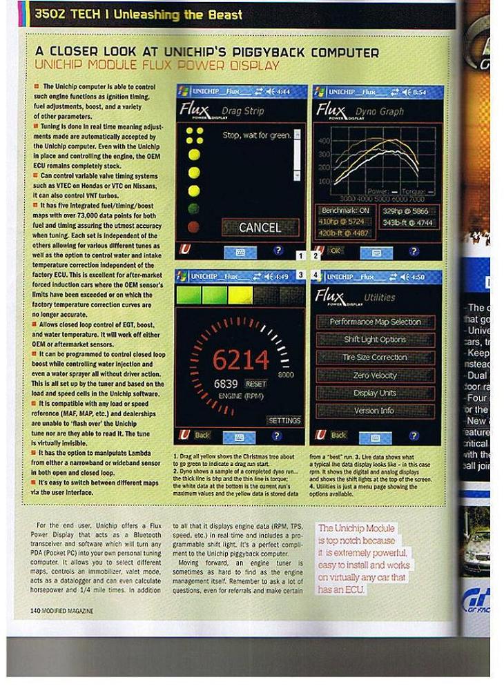

5 map ability with a stand alone 5 position switch (on the fly)
Closed Loop Boost contorl (tied to 5 map switch)
Of course fuel and timing control
Bluetooth access to the Unichip allowing simulated G tech style measurements along with the ability ti switch maps via the bluetooth link. Can also watch real time reading from the engine via the link and alter the tune via the link as well
6 channel datalogging via the bluetooth link
Plug and play harness
etc. etc
I'm attaching a excerpt from Modified Mag on it (they used it to tune their built motor Turbonetics Z)

According to Unichip it can control VTC on Nissans. Its in the attachment I posted.

The only kit I have any data on is the Modified Mag car that article shot came from. They were limited by the turbo size a bit and a crappy exhaust.
