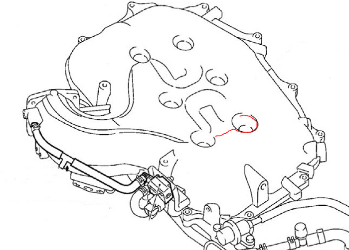

basically....it is a small hairline crack .... lemme see if I can draw a picture
edit: it's the red line in the picture and it's approx the thickness of 4 sheets of paper
Hmm..thats a tricky area to weld. It could be done, but your best bet is a used plenum...sure they are dime a dozen these days.
