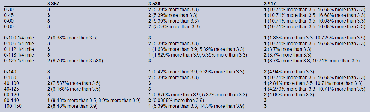

ok well I took a look back at my text file I made at work and after looking it over there's a few things that I guess should generally be pointed out from my findings anyway (people are free to disagree if they want, but I'm pretty sure this sorta thing is how a lot of race teams decide on what final drive they want for a particular track given the average speed ranges for that track)
Overall it looks like the 3.3 FD is the ideal choice for races that start in the 80-100 mph range and go up from there. It can start accellerating in 3rd gear where the other FD's would have to use the 21.3% weaker 4th gear which far outweighs the 3.3's weaker FD ratio.
The 3.9 seems to have the advantage (by 10.7%) when it starts at any speed between 0 and 50 mph and goes up to any speed after that.
The stock 3.5 is pretty much a compromise between the the 3.3 and 3.9 - not really being the best at any range or by much the few times that it is
but obviously your dyno and boost curves, traction, and budget will ultimately dictate what you should get, not just raw overall gear torque
I picked speed ranges where I'd choose the ideal gear for starting and ending for the given speed range. I tried to base things off of what you'd do in the real world in a race. Most people don't mind reving to 6800-7000 rpms in 1st-3rd gear, but usually won't do that in the upper gears unless maybe it's that last final gear you're in during a 1/4 mile run. I used 295/35/18 as the tire size that I based everything on. If your tires are taller, you'd have a higher top speed in each gear so you might possibly do better on 1 or 2 of these speed ranges. And if your tires are a lower profile, then your top speed in each gear would be less and you might do slightly worse in 1 or 2 of these speed ranges.
Like I said earlier, all I'm doing is calculating the gear multipliers with the final drive. The hp/tq that the engine makes or the weight of the car or drivetrain parts have no bearing on these results - either does how fast you can shift. Actually time isn't even really factored into any of this, but you can probably bet that if you have 100% traction and can make use of all the gear torque for whatever scenerios, the higher gear torque will accellerate you faster. So anyway, this just adds the gear ratios uses divided by the number of gears used in then multiply that by the final drive. Things can be made more accurate if you factored in exactly what % of these speed ranges you're in each gear etc, but meh that's pretty tedius and I don't really think it'll change the results a whole lot anyway...
one of the things that some people might be interested in is that the 0-125 mph scenerio where everyone with FI has gone to the 3.3 has ran faster times and if you calculate the gear ratios, that shows the same result, however the 3.9 is actually supposed to be the faster method to get down the 1/4 mile @ 125mph if you can manage to pull off 100% traction, however since the 1/4 mile is timed the time it takes for the extra shift probably won't make the 3.9 worth it over the 3.3 FD
The first image is the simple table that shows which final drive came in 1st, 2nd, and 3rd place for that particular speed range as far as total overall gear torque being put to the ground
the second image is a more detailed version of the first table showing the difference in % that one setup has over the setups with less total gear torque. For instance one car that got 1st place might be by a huge % or just barely was better than the 2nd place car

2 shifts
3.357
1.624
1.271
= 4.358
2 shifts
100-150 mph
3.538
1.271
=4.017399
1 shift
3.917
.794
=3.513549
1 shift
3.357
1.271
=3.8118
1 shift
