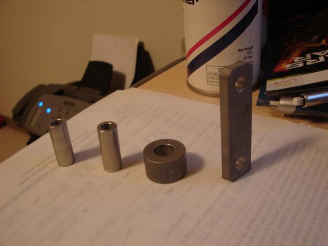

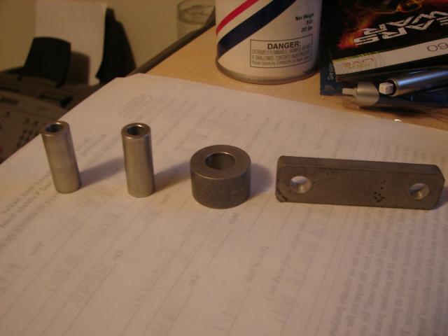

Ok guys i just bought myself a Vortech S/C for a great deal by getting it used...Now thing is i was going thru the kit got everything besides the 5 out of 6 mounting bolts to the engine and it seems like 1 of the spacers that goes behind 4 bolts is missing...Now i know i could probably get away with finding the supplied bolts but that 1 spacer i dunnno where i could possibly get...Also have this other bracket/spacer that i dunno goes where...Hopefully someone can chime in here and let me know???Would like to get this installed sometime soon....
Some pics attached....The one on the right is what im wondering about....

You know , Ive taken off my blower 10 times myself . But never seen or taken off the bracket myself . If no one can come up with it . Call Vortech , talk to a tech and tell him your going to email him the same pics . That way he can tell you where things go , and send /sell you what you need .

If Im not mistaken the spacer dimentions are in ur installation book----Epoxy the spacers to the bracket ---It will save u headaches when u lower it down. The bracket u have on the rt, for the life of me is not for the kit. Where did IT come from ???
The spacer u are missing is like the ones on the left but shorter

Well i went ahead and measured that piece on the right and its .250" width and the inside hole is the exactly the same as the other 2 so im going to assume this was the spacer he made so it could work....Anyone see a problem with this spacer?

dont buy it from vortech, they charge like 2 dollars+ for each bolt. I went to home depot and found the missing bolts and nuts off my used vortech and a mom and pops hardware store and got all the missing parts. The vortech instructions tells u the size so just shop around until u find it. I think I got all the missing parts for under 2 dollars and vortech wanted 10 + shipping.
