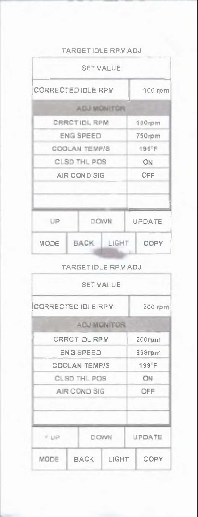

If you're interested, my idle readout when it was increased. But I don't use the same management system as you do.
G
