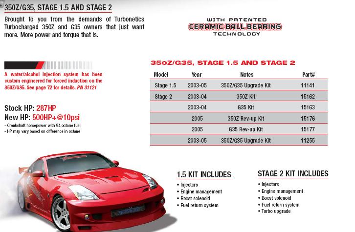

And just in case heres the section of the Turbonetics catalog related to Stage 2..
