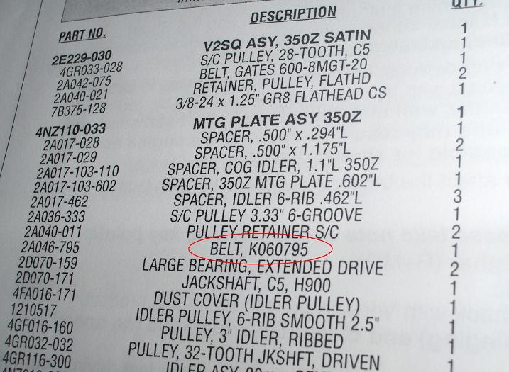

Originally Posted by Gilley
Is that a new tuner kit? They must have changed the belt routing if it is a new kit.
By golly you're right. . .I see on the parts list page (vi for 03-05 Zs) it lists an un named belt: K060795 Implying a 79.5" belt. My manual was printed on 06/07/07. The online manual lists the belt as BELT, 4060935-GOODYEAR. That's the 93.5 incher. Also, here are the routings from the online manual to my manual. Looks like they omit a bunch of idlers now. Interesting. I have an extra idler pulley now.
Sorry for the crap quality on the pictures!

wow they route it totally different. I would think the new way would slip ezier.
I was wondering the same thing. . .I'll keep everyone posted when I get it all installed and start monitoring boost levels.

Interesting...so since my used kit came w/the 79.5" belt, I guess it's a "newer" kit, huh?

I was wanting to know if the 79.5 revised belt is for the standard 3.33 pulley also. I also contacted motion industries with the gates 79.5 part number in this thread and they told me that I need to go napa. Does motion industries have their own part number for the 6 rib belts?
