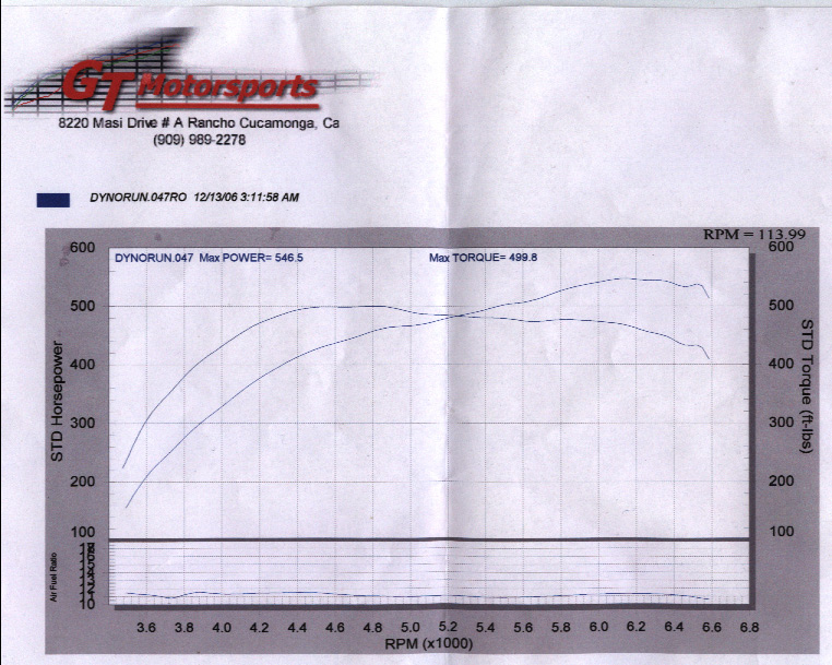

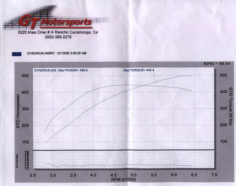

Low Boost - 500 rwhp, 10psi
High Boost - 546 rwhp, 13psi, 500 trq

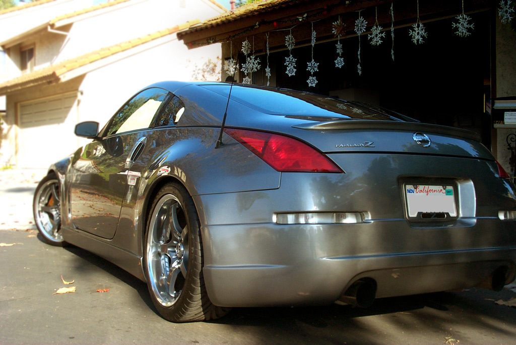

Nice car. Can you take some more pics of how the APS 3" looks with that rear bumper ?

I believe its a DJ....I'll try and snap some more pics this week...

nice numbers, that's one of the flatter APS TT torque curves I've seen.
One question though since the car is the exact same car between low and high boost runs - as in same exhaust, same test pipes etc. Why is it that at 3500 rpms on the low boost setting you have 340 tq, while on the high boost setting you have 220tq at 3500 rpms?
obviously the higher boost run wasn't recording until 3500 rpms where the car started going WOT, while the other one started at 2800 rpms when the car started going WOT
I thought the APS TT was supposed to have almost no lag at all and be fully spooled by around 3500 rpms
The hks EVC boost controller has the ability to set two different gain setting for the high and low boost ,I always set the gain higher on the low boost setting to ramp the boost faster .ramping the boost will defiantly give you higher torque reading initially .hope this make sense
