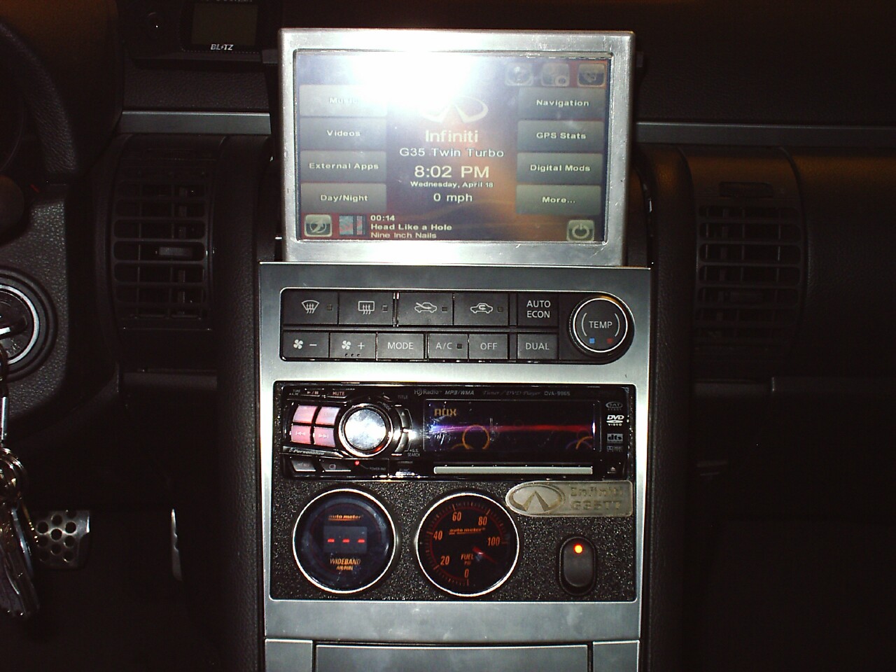

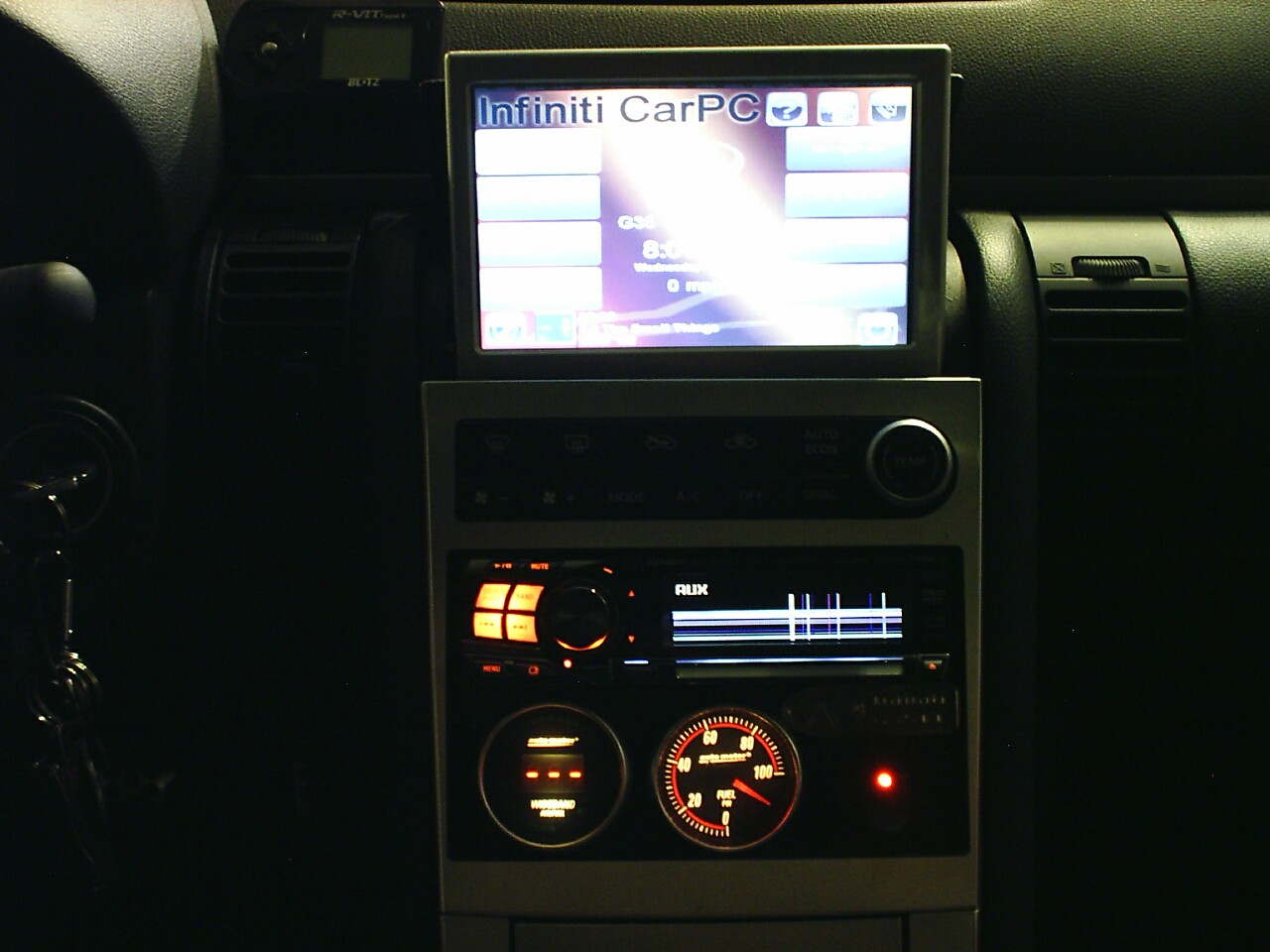

Ok, here's a couple of pics of the wideband A/F gauge installed. It also includes my fuel pressure gauge, and my CarPC screen. The three pics are the same, just with different flash settings. It's hard to get it right with my PoS camera.
Dave
