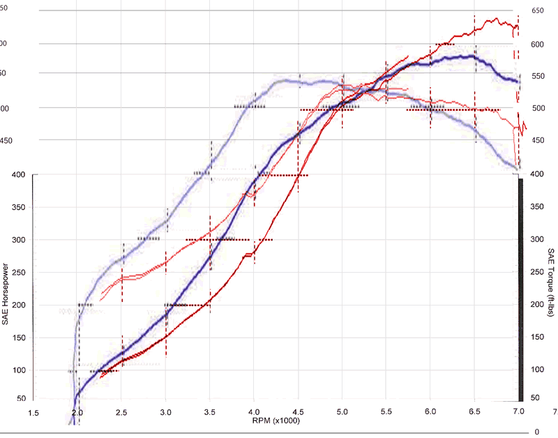

for comparison, Charle's (Phunk)'s Greddy TT dyno chart (shown in blue)on his site is the closest thing I can find. He's running 14.5 psi and head porting, but 8.5:1 compression ratio. Also with JWT cams etc
http://www.cj-motorsports.com/cjmz/20.jpg
overlaying the two graphs shows you the ballpark differences between the two turbo kits
(I'm sure the location and dyno will vary the numbers a little, but you can still see the difference in shape of the curves)
but yeah, the SFR is a kit you want to rev to 8000 rpms with

From my experience with the greddy kit, this SFR kit seems to spool the same w/ a wide open exhaust. Can't really feel that much lag, and the power hits you hard from the 4k-5k just like the greddy kit from the huge power jump and it just pulls harder and harder to redline. Wish I'd gone w/ this kit in hindsight lol. SFR kit is easily way streetable.

Thats great. With a curve like that...higher numbers seem inevitable.

Lol is there a race to 1000rwhp? Thats a nsty power curve. I guess the whole problem with getting top end in a FI Z was the size of the turbo.

Don't mean to take away anything from the numbers, but i can't believe no one has made a point about the SAE correction... SAE correction is NOT valid at such high elevations FOR TURBO CARS, assuming that this was done near Englewood, COLORADO (5369'), where Juztin's location is? SAE dynamometer corrections was instituted to predict (rather accurately) performance of NATURALLY ASPIRATED cars at different altitudes and temperatures, by essentially computing density altitude.
Here is the formula: CF=1.18[(990/press)xSqrt((temp+273)/298)]-0.18
(pressure is in millibars, temperature in celcius)
So, with pressure of 831 millibars at that elevation (approximately) and a temperature of about 50-55 at 3:40pm (we'll use 50degF=10degC), the correcton factor is a rather high 1.1899, or additional 19%. SO whatever number it measured, it added 19%. That's huge. So, at sea level, that's 538hp/446lb-ft and NOT 640hp/531lb-ft.
SAE correction is not an issue if you are near sea level, since it's small, and does not skew the numbers. Englewood, CO is at 5369' above sea level, with a high of 57degF on the 21st; I am assuming the temp was not much different on the 20th of February.
I am just doing this for the sake of integrity. Numbers lie all the time, and must be interpreted correctly. This is what happens on public forums, where people can come in and post things, sounding like they know their stuff, and mislead everyone. I am only saying this to bring some objectivity, that's all, my opinion of that turbo kit notwithstanding.
Now, if this was NOT done in Colorado, than that's something else, but i am sure it was.

seems like the only great measuring stick to see who's d!ck is bigger is the 1/4 mile. There are too many different dyno and adjustments to fairly compare.
the top end of the graph is mighty nice though!!
