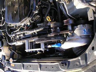

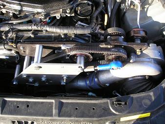

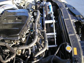

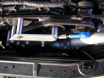

Here are some quick pics . Like I said we didnt make as much power as I did at 13 to 14psi because of the huge amount of timing being pulled . It got up to 383whp I think ,389whp maybe . I will have to look . We just printed out the numbers and not a dyno chart . It was at 250 kpa which is 21.7psi @6690rpm's .
A new EMS is on the horizon , but Im leaning towards the Utec because the Hydra isnt controling the AT5 .

Im using the 32 tooth on both sides of the jackshaft . Which is real close to having the 3.12 serp pulley . If my old set up [ 34 tooth cog and 3.12 serp ] would have not slipped . It would have made more boost than this set up . So the belt was actually slippinjg much sooner than I thought it was .

Is that rod on the jackshaft there to help prevent the premature wear on the jackshaft?
