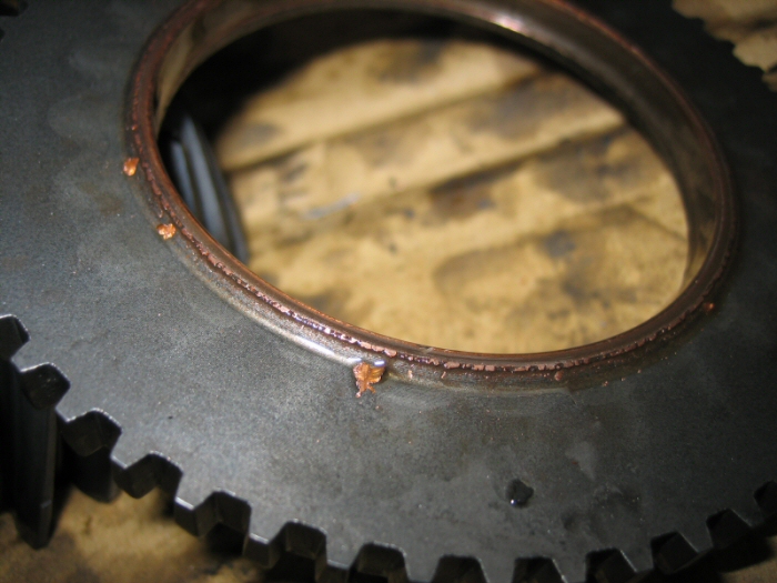

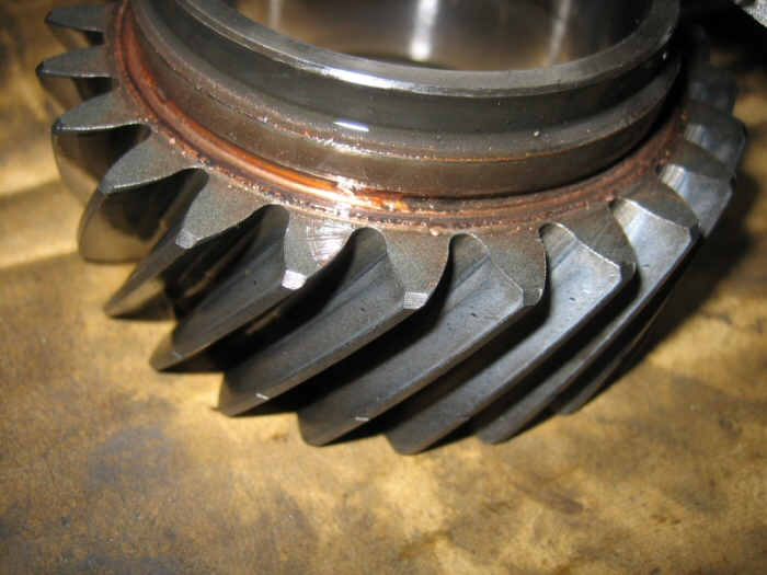

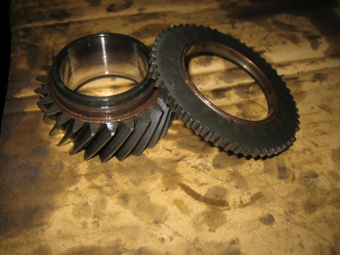

I've got the same problem with the 3rd gear.
The engagement gear section of the 3rd gear broke off from the main 3rd gear section.
Like BriGuyMax said, they seam to be laser welded.
It would be better if this would be one piece
Here are pics:
Attached Thumbnails Transmission completely DIED in 3rd-img_0565_klein.jpg   Transmission completely DIED in 3rd-img_0566_klein.jpg   Transmission completely DIED in 3rd-img_0567_klein.jpg

The engagement gear is actually brazed, briguymax mistyped.
Separated engagement gear was my initial thought when I read the thread too, then I realized it's like 5 months old, but yeah. I'm sure that's what happened.
