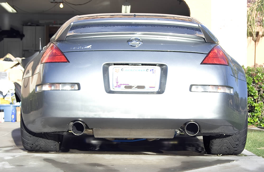

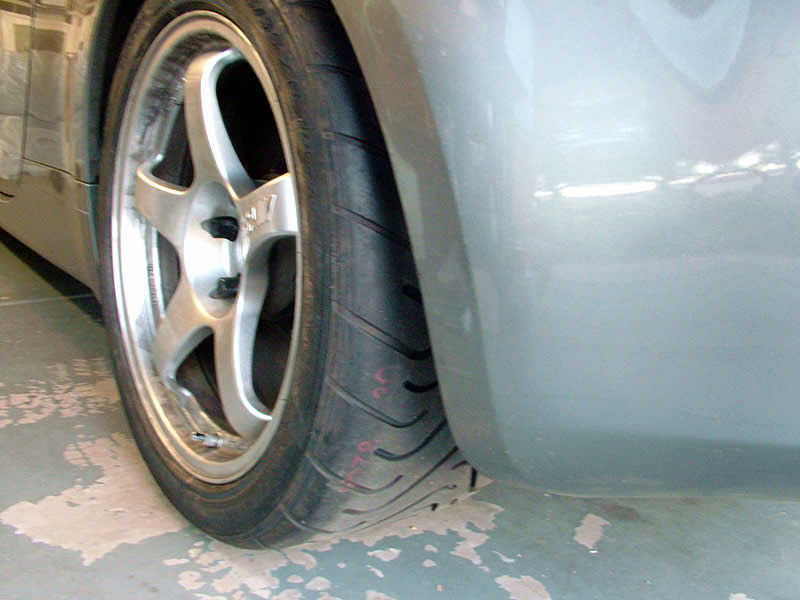

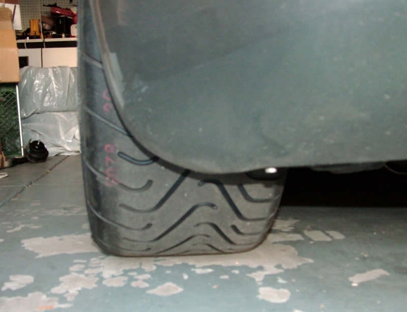

295/35/18 pirelli corsas in the rear
http://www.tirerack.com/tires/tires....el=PZero+Corsa
I replaced my Michellin PS2's I had (same sizes) and the extra grip was very evident. Mine were even made a year and a half before I put them on, so they weren't really in their prime. They're supposed to last about 5000-8000 miles of "normal" driving with a treadwear of 60
They're pretty nice tires IMO, but I think they're slowing being phased out of production. There used to be a couple other sizes that are no longer available and Tire Rack is charging a lot for the 295's now (especially the rights) and you can't even get 315's for the right side anymore (they're directional tires)
anyway, the Nitto NT-01, Nitto NT555RII, Yokohama A048, Michellin Pilot Sport Cup, and a few others are all worth looking into for more traction and better handling without having to resort to using drag radials with soft sidewalls - which will have better overall straight line traction than normal competition tires
