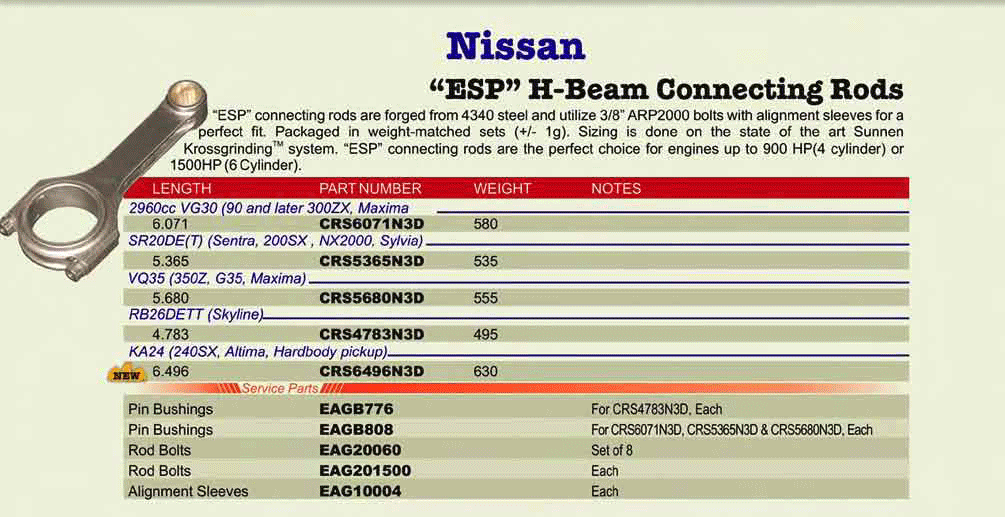

mild fi? according to eagle, their H-beam rods are good for 1500 hp in 6 cylinder nissan applications
Don't argue with IIQuickSilverII !!!! Eagle rods are only for losers making 1500hp or less.
250hp per rod is so very very weak!!
