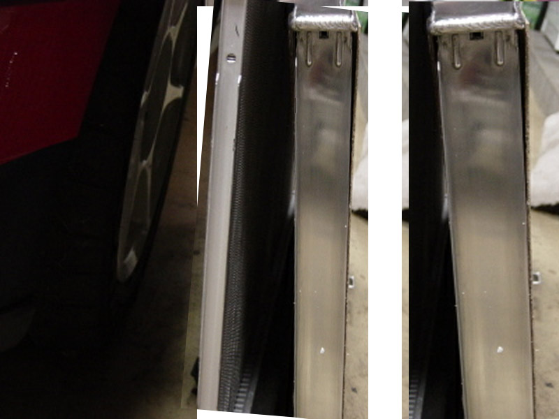

Originally Posted by Crom
The thin koyo doesn't do much better than ther stocker....the hoses are more for looks, the therm. helps a little. Maybe try a remote switched fan, oil cooler for sure.
hmm that's pretty weird because it's a hell of a lot thicker and holds a lot more coolant
attached pic is stock, 36mm radiator and 56mm koyo radiator
Attached Thumbnails Newest cooling mods.  recommend some more-radiator-ps-16-36-53.jpg

Take all your pipes out and heat wrap or coat them? NITROUS?
Nice pic. Yeah, I'm having to go with 36mm due to clearance issues on the turbonetics kit. I very much doubted the previous statement.
It is wierd...I know it doesn't make sense..just my personal observation.--I've been through the cooling battle through very hot traffic excursions w/ no ac.

I have the 56 in my jwt set up its real tight in there but its in.

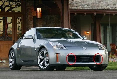

Originally Posted by USN HM 350Z
dont have that front any longer. Have stock with lip now
did you take out the black plastic insert? that helps alot, even replacnig it with black mesh maybe if you are worried about the interfooler being seen?
I took my black inserts out here to open the grill up a little more.
Attached Thumbnails Newest cooling mods.  recommend some more-06nissan-350z-1.jpg
