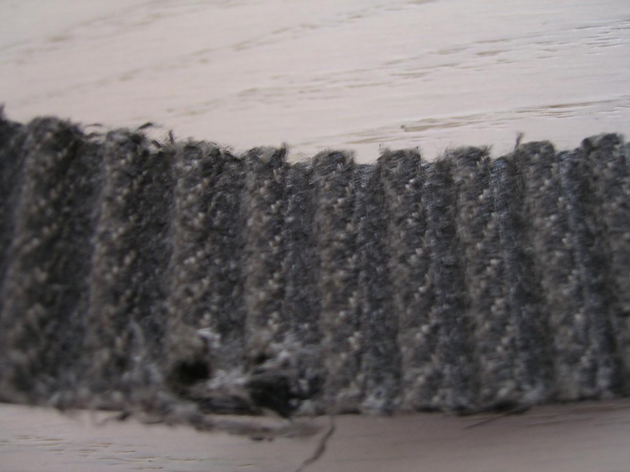

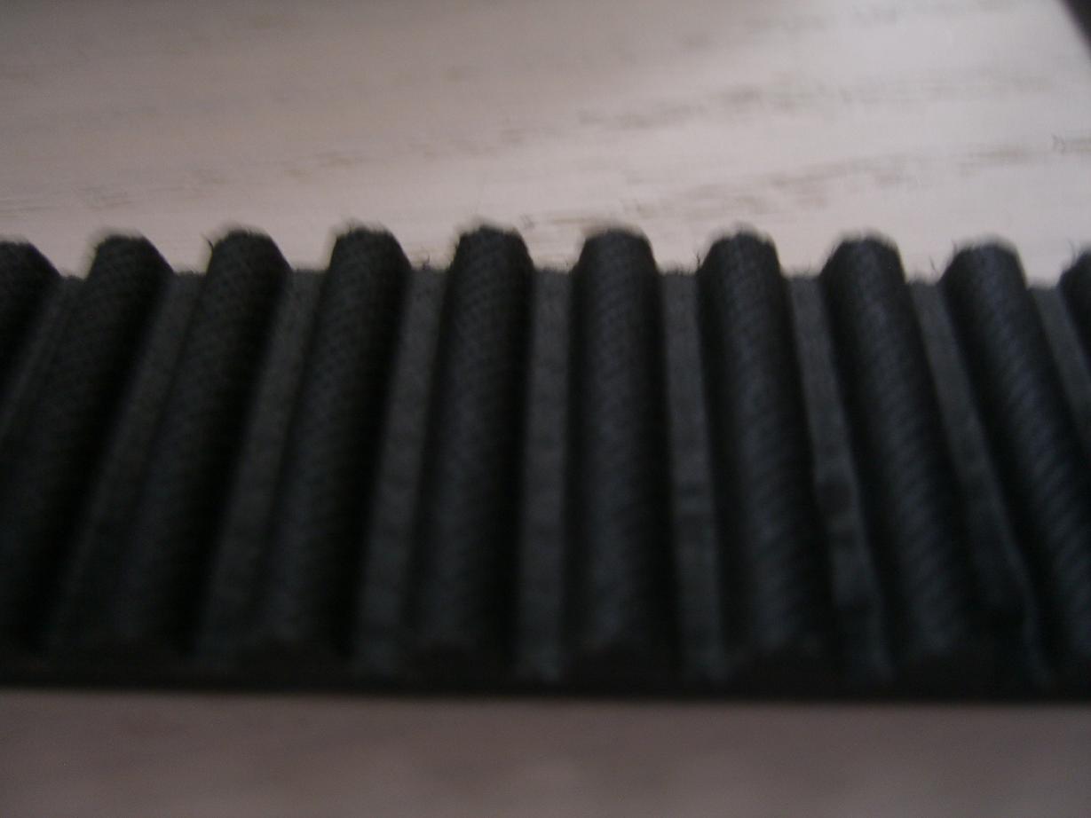

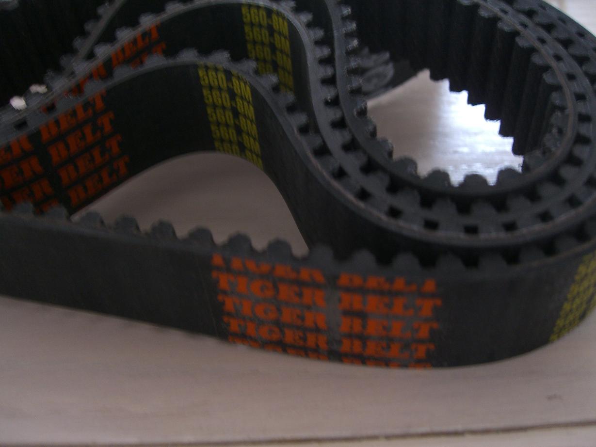

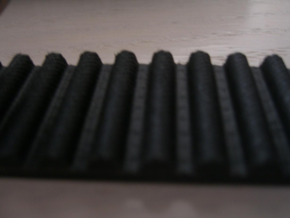

I just got some TIGER belts today from JASON at that shop and they are niheeeece!! Posting pics..

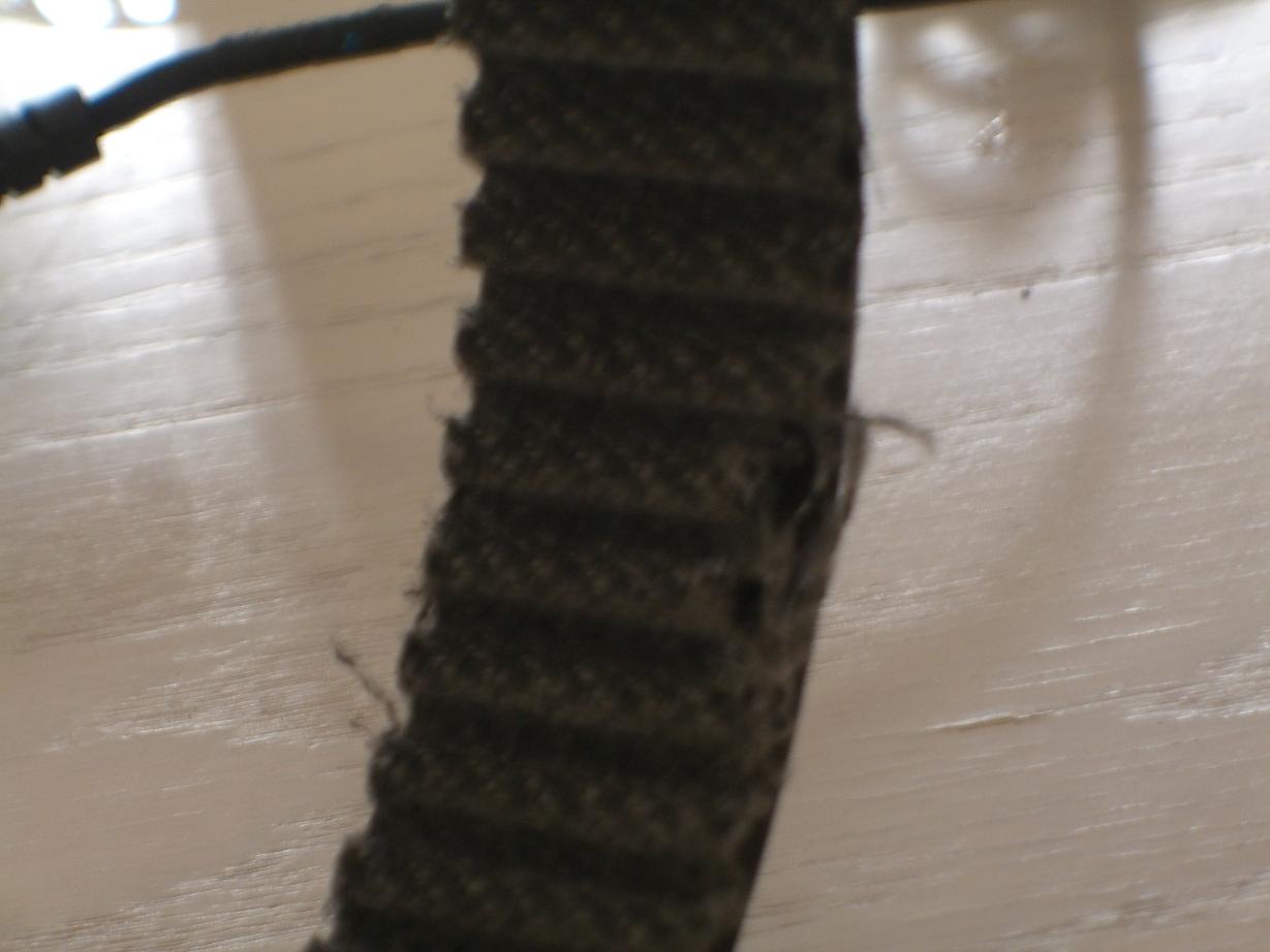

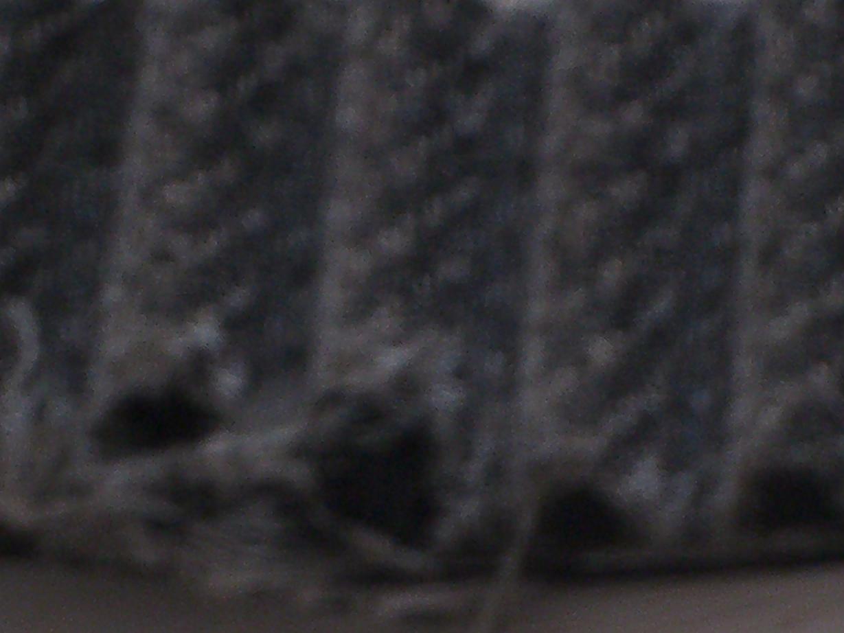

Pic 1-3 JASON TIGER BELT Pic 4-5 Gates POS belt after 1 week WOT..

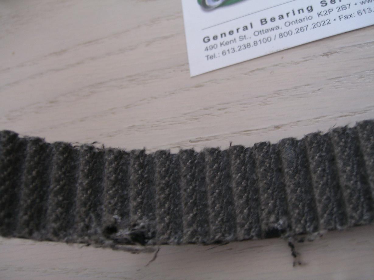

Some more of Gates POS belt.. I cant stress how cheap these belts are.. I have prob spent about 1k on them ****ty *** belts so far!!
JASON Belts FTW!!

Why does ATI eat belts
Old Aug 16, 2007 | 09:54 AM
Jay'Z's Avatar
Jay'Z
iTrader: (118)
Posts: 10,944
From: Carbon Fiber, TX
Because ATI is hungry..
Actually it eats belts at high psi like my 14-16psi pulley.. 7psi/9psi/11psi you will not see exact wear like the pics above.. It will take longer..
Also, exact alignment/cog teeth wear/tightness are all things that are critical..

Your cog pulley teeth being filed on probably has more to do with it than any thing . Others have ran that high of PSI on a ATI with out saying they ran thru belts like you .
Old Aug 17, 2007 | 03:00 PM
Jay'Z's Avatar
Jay'Z
iTrader: (118)
Posts: 10,944
Your probably right.. But im going to run these JASON belts for a while and see how long they last.. If they last long and dont break the problem wasnt the teeth.. Besides.. Changing the Pulleys would be a major PITA as I would hate to spend $200+ on paying someone to do it..
Im thinking the alignment I had was bad.. I never looked at it from above the pulleys and my tensioner pulley was pulling the belt off track of the cog teeth.. This was because I didnt have a spacer behind the tensioner pulley and I just rectified this the other day(The pulley fell off once after running the new routing of the belt= lost original washer/spacer)..
I overlooked the importance of that and once I really looked at the alignment I realized.. Wow.. I was way off center.. I hope you know what im saying..

Oh yeh....them pulleys need to be lined up or your belts are toast . Also at higher psi , the bracket starts to distort and will wear out belts sooner .

What do you mean distort?? Are you saying it loosens??
Old Aug 17, 2007 | 03:12 PM
booger's Avatar
booger
Posts: 10,500
From: council bluffs Ia.
No...it flexes , bends . The higher the psi the higher the trq. thats put on the pulleys and will actually make the bracket bend or flex .
Old Aug 17, 2007 | 03:15 PM
Jay'Z's Avatar
Jay'Z
iTrader: (118)
Posts: 10,944
Ok, because I looked at my bracket and.. This ATI bracket is rock solid IMO..... SOLID..

It has been about 4 days.. So far the belts are holding up really well.. I have been WOT like 70% of it....... lol
Ill post pics of the belt condition in another week or two..

Tell me about it.. Im happy to see the teeth are holding up.. And the belt running well..
Usually after a few runs WOT(15psi on defi@7000rpms) with gates belts you start to see the webbing of the belt coming loose and symptoms of the pics above..
