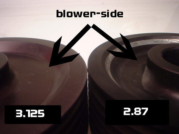

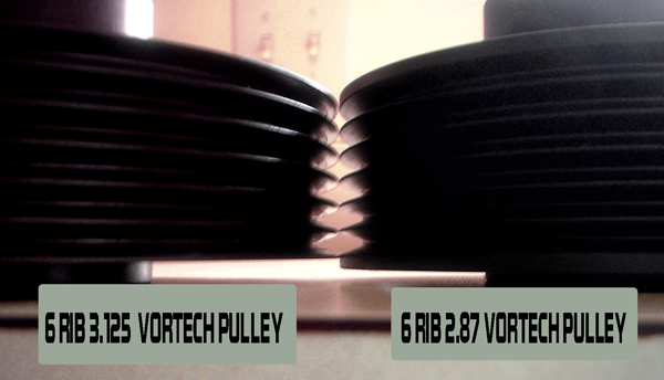

Originally Posted by Triji
I was reading this post by booger:
https://my350z.com/forum/forced-induction/85752-vortech-2-87-pulley-not-right.html
Here is a pic he posted of what happened when he installed the 2.87.
https://my350z.com/forum/attachment....7&d=1091575043
https://my350z.com/forum/attachment....9&d=1091410849
https://my350z.com/forum/attachment....6&d=1091408813
I just don't want to have these same issues as Booger did...
If you notice the date on that thread Triji .....it was old !! I believe Vortech corrected the pulley after that happened. I just wanted to show what happened to compare what MIGHT happen with a 2.62 . As I stated....I dont think the 2.62 will work...at least with out modding it any way .

The 2.62 rubs the s/c bracket. I had to space it out 1/4 of a inch rather than mill on the pulley or bracket. It's working fine. The belt is lined up great. No problems with it even at 6500rpms.
Old Sep 8, 2007 | 02:32 PM
booger's Avatar
booger
Posts: 10,500
From: council bluffs Ia.
What year is your car ? On mine [ 03 ] the jackshaft sticks out away ffrom the main bracket . And when I put on the unmilled 2.87 , it tore up the edges of the jackshaft as shown in this pic
https://my350z.com/forum/attachme...7&d=1091575043
What your saying is the the 2.62 hits the main bracket and not the jackshaft . Can you take a close up pic of it ?

Yeah the lip on the bracket is what the 2.62 hits.
Old Sep 8, 2007 | 03:41 PM
booger's Avatar
booger
Posts: 10,500
Im thinking you mean the jackshaft . It [ the jackshaft ] sticks threw the main bracket like in the pic . Still would be nice to see a close up of it though

also any pulley under the 3.12 has to be milled so it doesnt hit inside jackshaft and bracket.

so has it been concluded that any pulley under the 312 has to be machined to fit properly without having to worry about problems or did i hear that vortech fixed that problem... can we get someone from vortech to chime in maybe (steve) or other people that may know...
