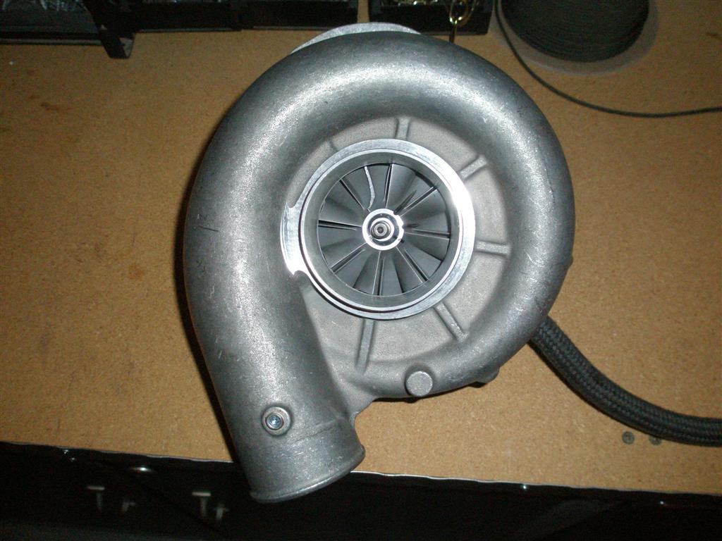

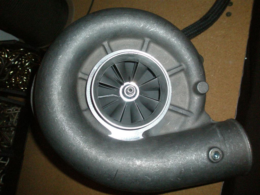

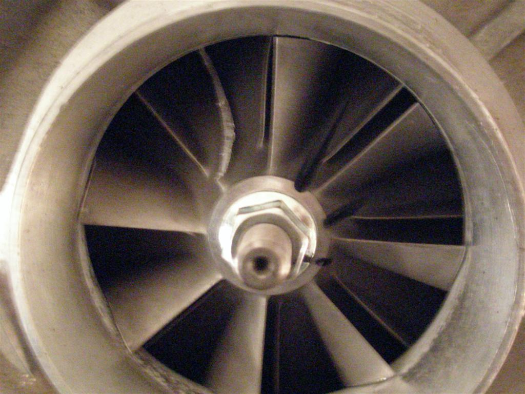

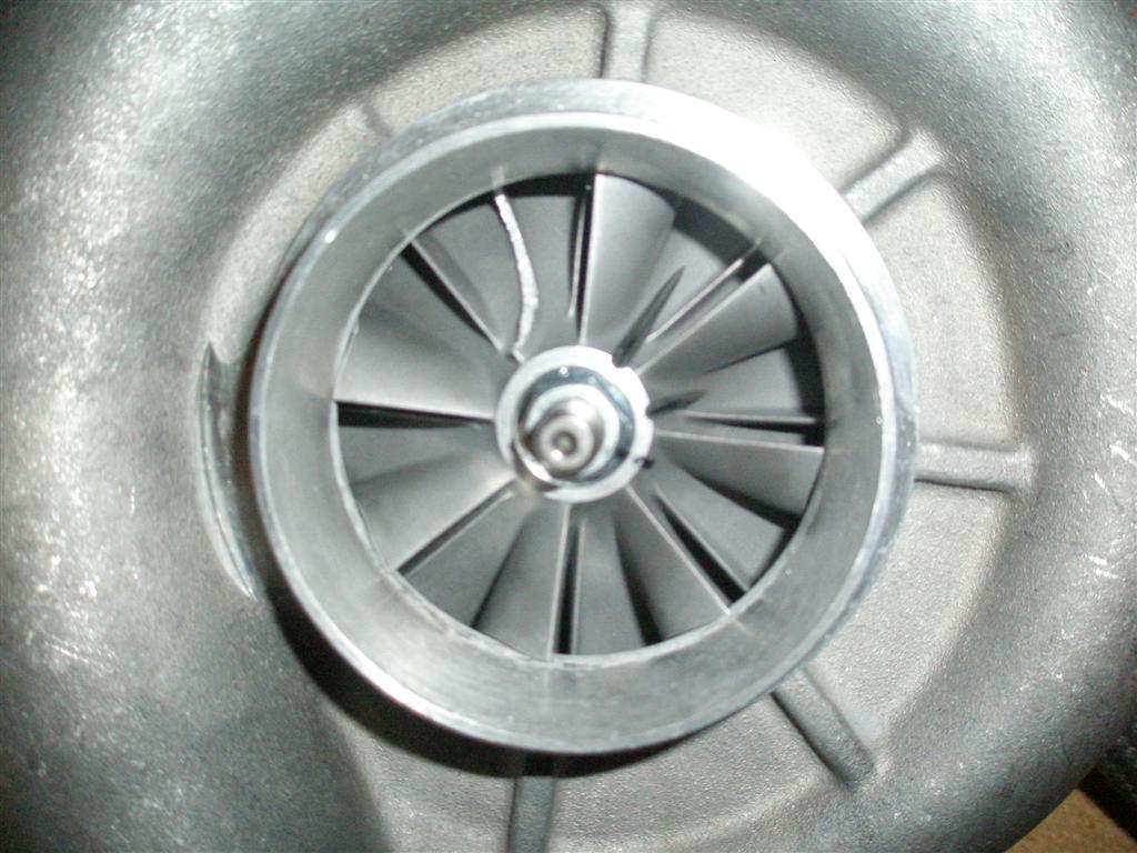

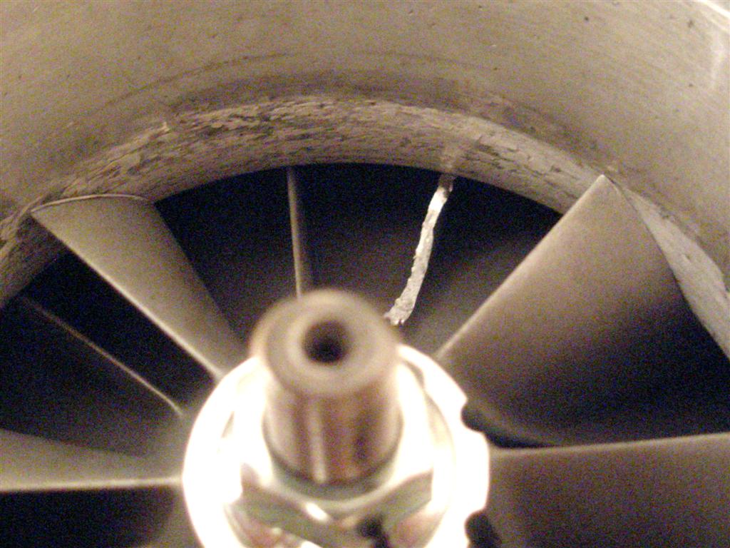

But we DID send pic's at the bottom of the post. Well here they are again. Hope you can see them this time

Funny, the service guy at Vortech said 'No, we haven't had any problems with the units we sold this summer'. He got real quiet when I related that the guys on my350Z.com thought differently. And started naming names....... I'll add yours to the list, if that's all right.

im trying to get to the bottom of this. when i talk to Vortech, they act to me like not that many people are having issues here in the past few month. i explain that over half of the 24 units that went out with our group buys have had issues already, plus a few that went out at the same time from other vendors.
our theory is that maybe they tried to use some different bearings on these for a while and it backfired. once they are sent in and serviced, they all work properly after that.
i think that Vortech should offer a mandatory recall on all the units that have "something" different in them. im calling again today...
Hello, Jeremy. Thanks for all of your help in getting this sorted and, as you can see, we are having our own 'bug-tussle' with Vortech. I did drop your name when talking with them this afternoon and they acted like they had never heard of you. Funny, them taking that attitude. They did say that they had 'gotten two units back from Sam at GTM but nobody else has been having any problems'. Well, we are probably doing the 'liability dance'. They are based in Cali, after all.
