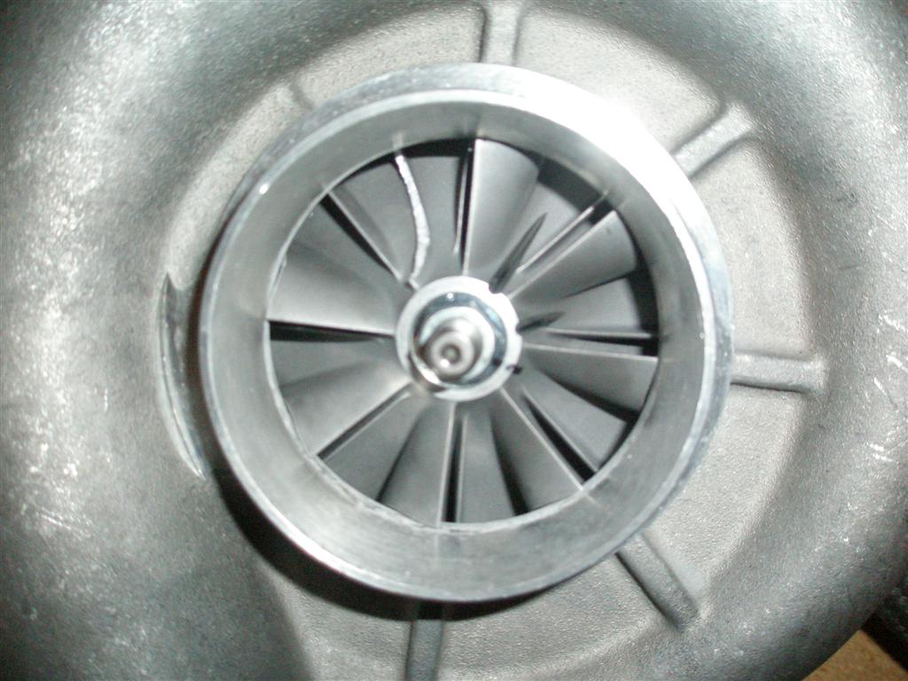

Well, I guess you could say this is a follow-up to the verrrry long post we did for the install. A most unhappy follow-up, unfortunately.
We have been driving the Z for the last two weeks and my husband has been taking it back and forth to work. The boost was great and the car was a blast to drive with absolutely no complaints. All told, we put about 600 miles on the car during that time. We did note that the supercharger was sounding louder and louder when we first started it up but it would quiet down in a minute or two and everything seemed fine so we pressed on.
Five days ago, while driving home, my husband noted a sudden change in the 'turbine noise' coming from the engine. There was a low, coarse vibration but the engine continued to run so he finished the last 10 miles to home. Once in the garage, he left the engine running and opened the hood. The supercharger was literally squealing and was so loud it hurt my ears. We shut it down and checked all the belts and pulleys and hoses, etc. (all the external things) and nothing was out of order.
The next day we went over the car again and did not find anything wrong. We decided to drive it around our little neighborhood (so we would not have far to walk if anything went wrong). The noise and vibration got louder and harsher and just before we took the car home we got the VDC, SLIP and SES lights turn on and the car went into 'limp home' mode. We got the car home in a minute or so and stopped the car immediately and checked the codes on Cipher.
We had a problem with the Throttle Actuator Control Module and the Wheel Speed (ECU code P2101 and ABS code C1131), supposedly. We have checked with some trusted sources and have been told that this can be seen when the throttle actuator acts up and there is a TSB out on it for repair under warranty. Any other thoughts or input on this would be appreciated. We hope that we have not FOD'ed (foreign object damage) the engine.
Of course, this does not explain the supercharger 'melt down'.

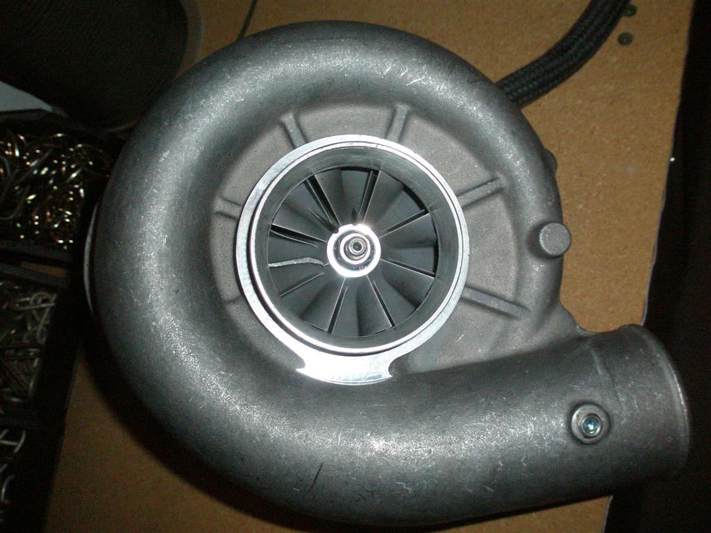

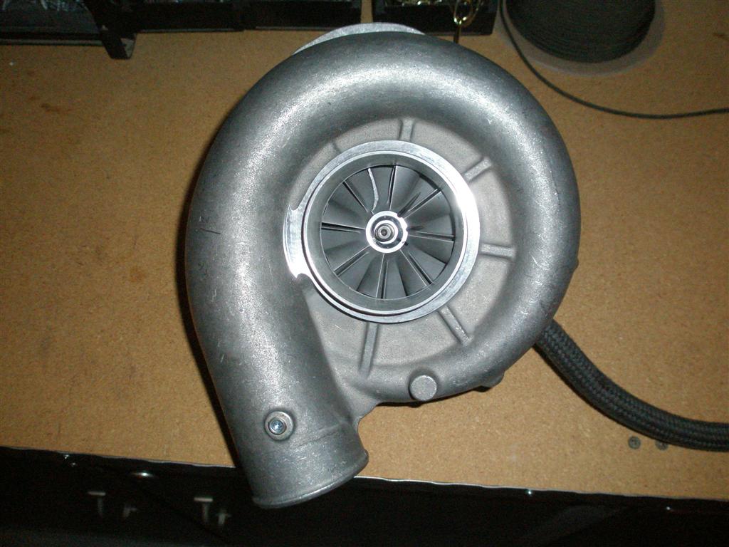

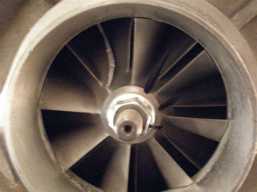

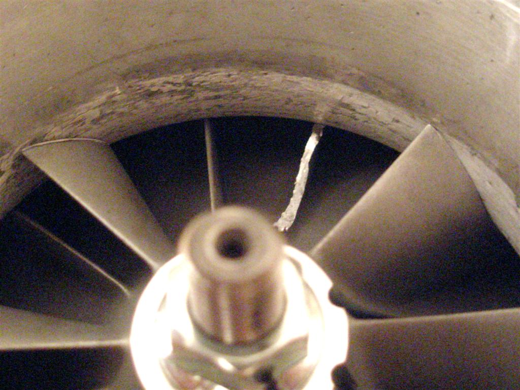

We took the supercharger off and this is what we found (see pictures below).
We also found that the central shaft was bent and moved up and down when we spun the turbine blade and there was the sound of pieces moving around inside of the housing. As you can see, one of the blades has disintegrated and the others had been hitting the housing with three of them having damage/curling at the end of the blade where they had been hitting/scrapping the housing.
It looks like the bearings were defective and the turbine was loose in the housing and struck the sides causing even more damage and breaking off one of the blades (which we have still not found). The throttle body error codes (hopefully) were co-incidental and we are still looking into that. We are going to take the charge-cooler off and blow air back through it to get rid of any remaining bits and pieces, get the supercharger replaced under warranty, and put everything back together. We would appreciate any input as to other things we should be looking for, fixing, etc. when we do the rebuild.
There have been a few threads about the recent spate of Vortech failures and I hope this helps others to recognize the symptoms before serious damage happens. We are still convinced that the Vortech is a good way to go FI and will be back amongst the ranks as soon as possible.
