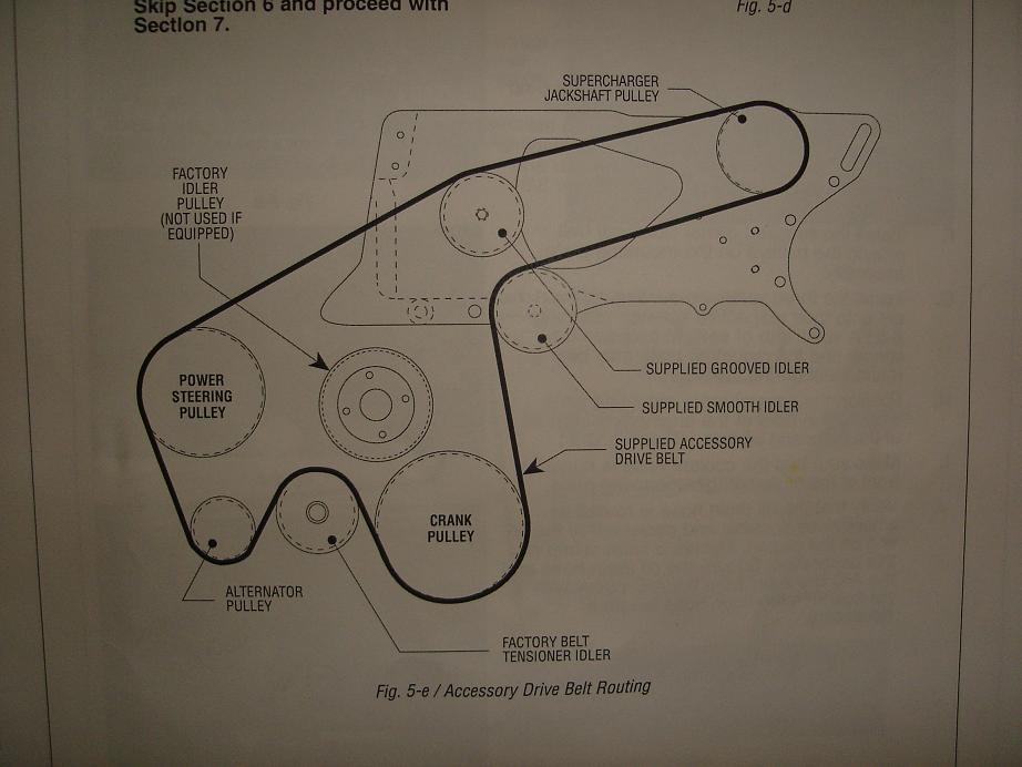

Originally Posted by sentry65
inside the jackshaft - the main pulley that turns the jackshaft
and the jack shaft is the one that is going true the Vortech fixation plate... ? with pulleys at both ends on both sides...?

Old Nov 27, 2007 | 05:04 PM
sentry65's Avatar
sentry65
the burninator
Posts: 9,722
From: phoenix, AZ
yes
