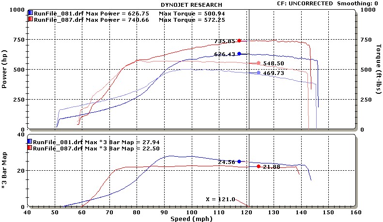

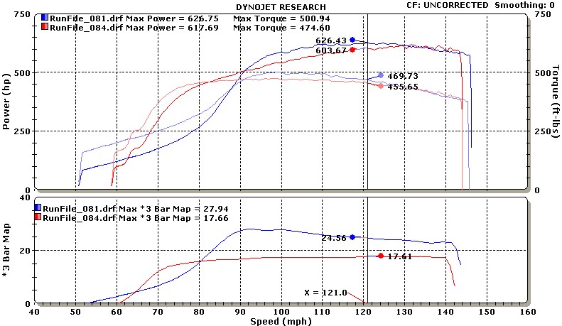

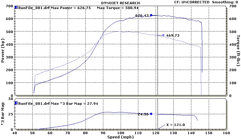

Originally Posted by Alberto
Wanted to add, Id like some shops input on what they consider a "big" shot to be on top of a built block plus basically maxing out a turbo kit. For example Id imagine a well tuned 100 shot on race gas + 18-19psi on a Greddy kit wouldnt be a problem for a built block, getting that insane TQ and power down is another issue, but that is neither here nor there.
Here are some graphs of an auto IS300 we did. On just the turbo all it would do was 626rwhp. The turbo was simply tapped out and wouldn't make any more boost. With a single nozzle with the boost controller off it would make about the same power. With 2-3psi less boost it would 740rwhp with the nitrous.
PR1=turbo only
PR2=WGSP + Nitrous
PR3=21-22psi + Nitrous
I plan on putting nitrous on my Greddy TT kit. It should make 800-850rwhp.
A properly built and tuned engine with your setup would handle 18-19 psi and a single nozzle fine.
PR1=turbo only
PR2=WGSP + Nitrous
