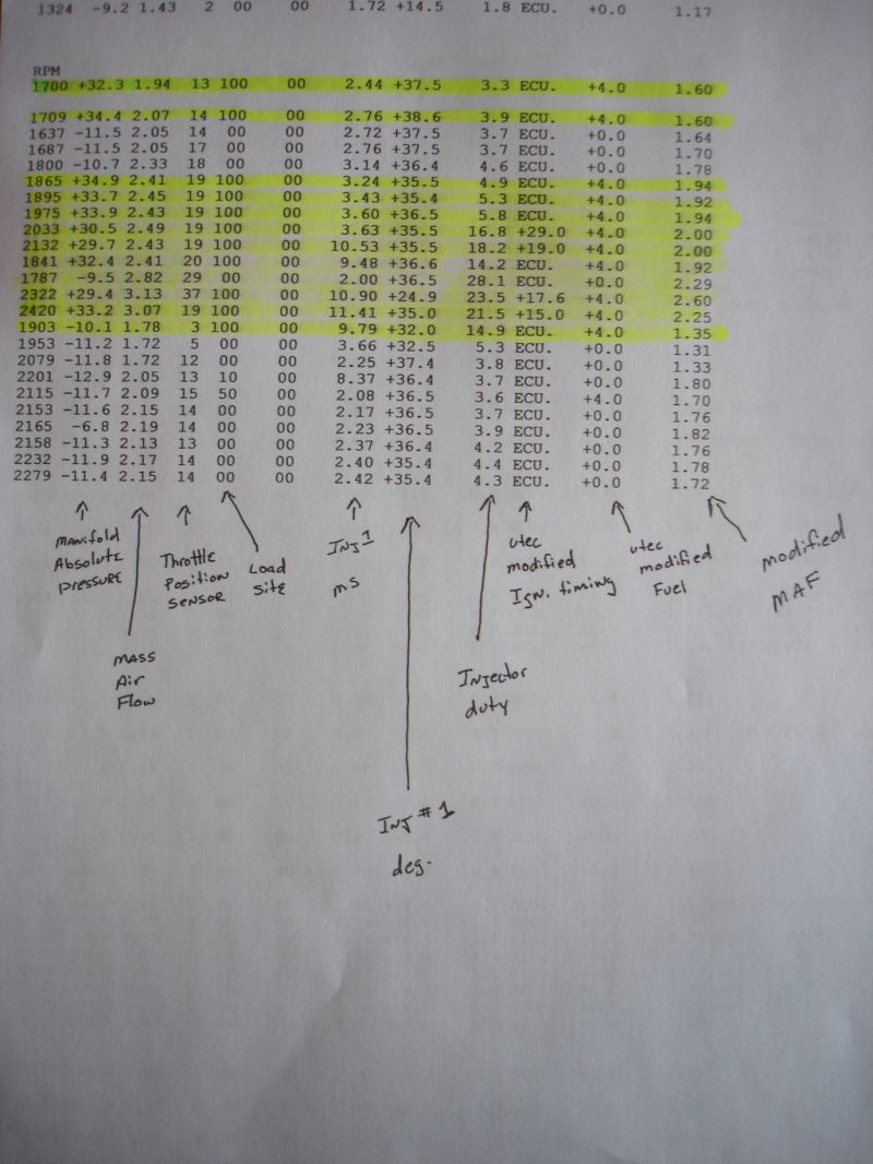

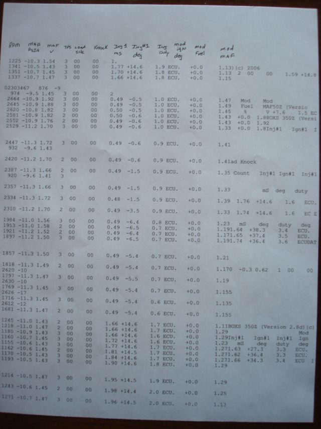

Having a hard time figuring out a problem with my Z. I hooked up my laptop to my utec and took it for a spin. I have had problems with it running strong then studering and even dying. I captured some interesting info if you look close at the highlighted info you will see the numbers are off the chart compared to when its running well. I'm not sure if this is a utec problem, or a throttle sensor or what but if anyone has some advice I'm all ear thanks.

Any TPS codes? I am leaning towards a faulty UTEC.
Do you have your Molex connector plugged in, and the black wire grounded?

No I've had no codes, and yes I've grounded the black wire. Not sure what you mean by molex connector but everything ran good for a quite a while. But it is getting worse. I don't understand the MAP how could it go from -11 to +34 a second latter. Think the map sensor could be a problem? But I am leaning to the UTEC also.

With both TPS and MAP signals going epileptic on you....now my vote is even stronger....time for another UTEC/send it in for repairs and provide from those data logs to TXS.
The UTEC has been very very reliable and stable, but a defect can happen from time to time.

Talked with Jermaine at Turbo XS, he's looking over my logs, they had me look for shorts in the wiring I didn't find anything. He told me to pull the unit and let it lay on the floor of the car to see if something was bunching up and causing the short. I did and it still acted up. Strange thing is today my timing advanced, injectors cycle increased exc but my MAP didn't change like it did yesterday. Very strange. I guess I'm at the mercy of Jermaine to let me know what he can do for me. This FI journey has been one PITA after another. But on the bright side I don't put many miles on the car, owe yeah thats because I can't seem to get reliable parts LOL.

i have never had a utec mess up after it was installed. if there was ever any issue, it was right when i started it up.
i think that something might be pinched or shorted out somehow. i have also seen the map sensors go bad and do some weird things to the utec datalogs.
im sure jermaine can figure it out for ya.

I spoke with Jermaine a little while ago and he is sending me a new map sensor. Praying that will fix me up. Jeremy when are you going to come to kansas and tune my car for me? LOL

did ANYONE notice he was hitting 34 psi @ 1800 rpms???
Or am i the only one....
Old May 5, 2008 | 05:36 PM
TinmansZ's Avatar
TinmansZ
Posts: 101
From: Kansas
I wish it was for real LOL. That was just my faulty map sensor.
Old May 5, 2008 | 05:42 PM
Julian@MRC's Avatar
Julian@MRC
iTrader: (28)
Posts: 5,510
From: Spotswood NJ
Problem solved... Glad to see no one picked up on that..Thats the first thing that jumped right out at me...
