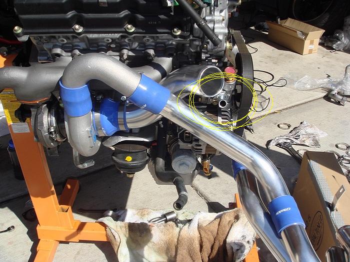

Old Apr 9, 2008 | 03:02 PM
KarenZ's Avatar
KarenZ
Posts: 77
From: California
in the circle is the piece you need...
it goes straight
hope it helps...

hmmm...... i also dont have that big cast elbow coming off the turbo itself. i can tell by the wya some of the piping looks that this wasnt a GReddy piping kit, so maybe the routing will be a little different

just installed my PS connector ten minutes ago the fitting is sloppy :/ and the welding looks like hell!! im glad i bought new, because as i was installing it i was wondering if all the used kits people were selling if they were taking all these small extra pieces off!!
Good luck with the fix, i cant believe they dont have any in teh US :/ . if you lok at the karenz picture that PS part is just so that pipe that goes to the inducer can make its way to the front maybe you can make something out of the stock setup...good luck
